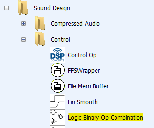

The LogicBinaryOpCombination module can be found in Sound Design/Control folder or by using the search window in the module browser.
![](../../__attachments/3170895397/att_19_for_3037134876.png?inst-v=326272e9-cc04-48f3-a51a-5d633eb0a230)
Figure 1. Location in Module Browser

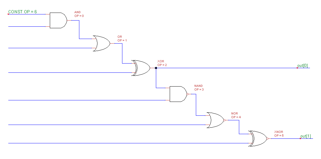

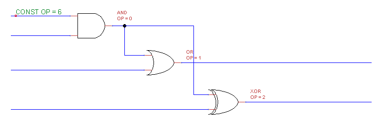

The following structures are invalid and cannot be implemented with the LogicBinaryOpCombination module. The LogicBinaryOp module should be used instead to build up these structures. You can combine the LogicBinaryOpCombination module with other logic modules as well.
![](../../__attachments/3170895397/att_2_for_3037134876.png?inst-v=326272e9-cc04-48f3-a51a-5d633eb0a230)
Figure 5. Error: One input of each gate must go to the module's input

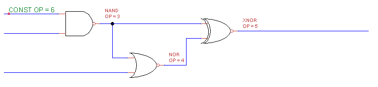

![](../../__attachments/3170895397/att_3_for_3037134876.png?inst-v=326272e9-cc04-48f3-a51a-5d633eb0a230)
Figure 6. Error: Gate input is not from previous stage

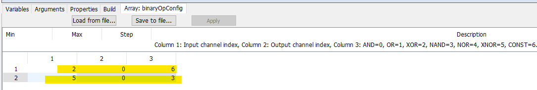

Now click on the Array:binaryOpConfig tab. Set the entries as shown, then click “Apply”.
![](../../__attachments/3170895397/att_6_for_3037134876.png?inst-v=326272e9-cc04-48f3-a51a-5d633eb0a230)
Figure 9. Edit array to set the desired function.
Confirm that the updated Module Variables are shown:
![](../../__attachments/3170895397/att_7_for_3037134876.png?inst-v=326272e9-cc04-48f3-a51a-5d633eb0a230)
Figure 10. Confirm settings
Please note that the first logic operation requires two operations.
A CONST operation to read the value of the selected channel
The actual logic operation you wish to perform with the next channel in the table
Subsequent logic statements for this output pin only add one row each in the binaryOpConfig array. However, to start a new output pin, you must again use the CONST operation.

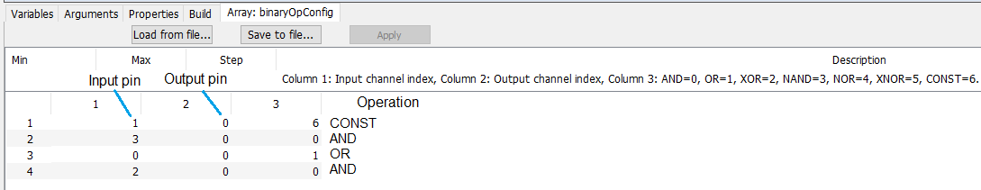

Here’s a module with 4 inputs and 1 output.
![](../../__attachments/3170895397/att_8_for_3037134876.png?inst-v=326272e9-cc04-48f3-a51a-5d633eb0a230)
Figure 11. numOps setting for multiple inputs
![](../../__attachments/3170895397/att_23_for_3037134876.png?inst-v=326272e9-cc04-48f3-a51a-5d633eb0a230)
Figure 12. Array settings for multiple inputs

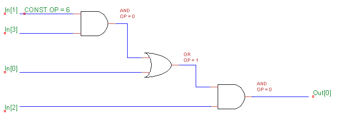

This implements the logic function:
Out[0] = (( In[1] & In[3] ) | In[0] ) & In[2]
![](../../__attachments/3170895397/att_9_for_3037134876.png?inst-v=326272e9-cc04-48f3-a51a-5d633eb0a230)
Figure 13. (( In[1] & In[3] ) | In[0] ) & In[2]

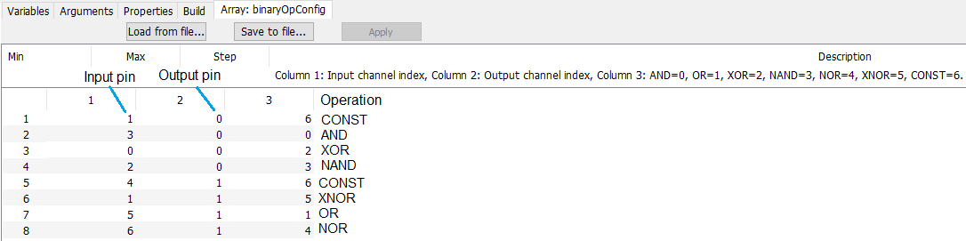

Multiple Expressions

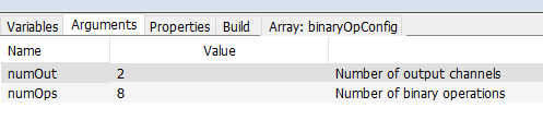

Two expressions of three operations each are implemented below. Note that it is possible to use the same input channel in both expressions. You can add more expressions by increasing numOut. Each expression uses a single output channel.
![](../../__attachments/3170895397/att_10_for_3037134876.png?inst-v=326272e9-cc04-48f3-a51a-5d633eb0a230)
Figure 14. Arguments settings for multiple outputs
![](../../__attachments/3170895397/att_24_for_3037134876.png?inst-v=326272e9-cc04-48f3-a51a-5d633eb0a230)
Figure 15. Array settings for multiple inputs
![](../../__attachments/3170895397/att_11_for_3037134876.png?inst-v=326272e9-cc04-48f3-a51a-5d633eb0a230)
Figure 16. Confirm settings

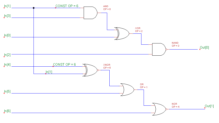

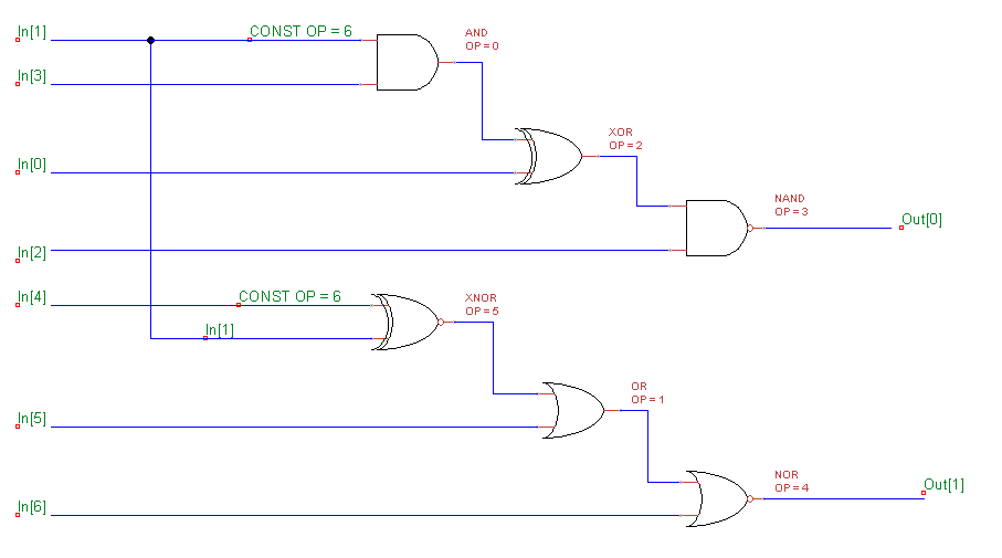

This implements the logic functions:
Out[0] = (( In[1] AND In[3] ) XOR In[0] ) NAND In[2]
Out[1] = (( In[4] XNOR In[1] ) OR In[5] ) NOR In[6]

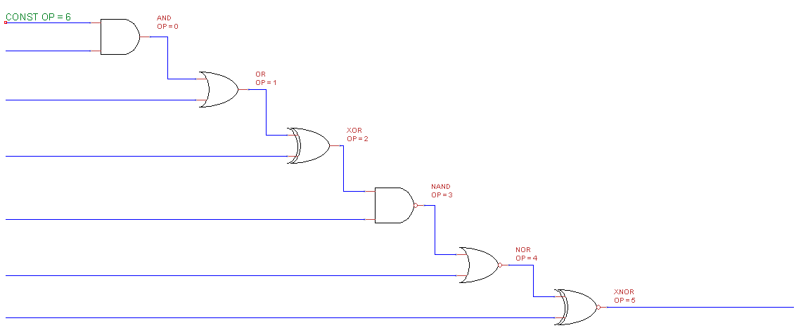

![](../../__attachments/3170895397/att_25_for_3037134876.png?inst-v=326272e9-cc04-48f3-a51a-5d633eb0a230)
Figure 17. Equivalent logic diagram

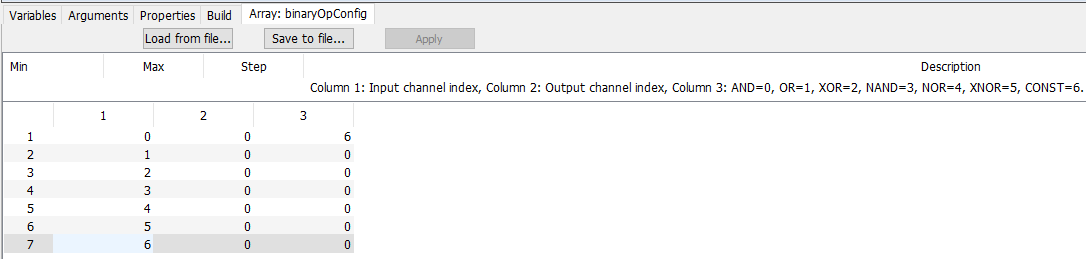

7-input AND gate
![](../../__attachments/3170895397/att_12_for_3037134876.png?inst-v=326272e9-cc04-48f3-a51a-5d633eb0a230)
Figure 18. Array settings for7-AND

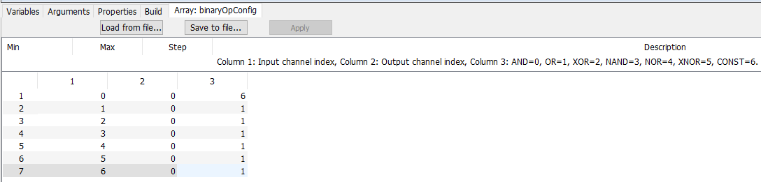

7-input OR gate
![](../../__attachments/3170895397/att_14_for_3037134876.png?inst-v=326272e9-cc04-48f3-a51a-5d633eb0a230)
Figure 21. Array settings for 7-OR

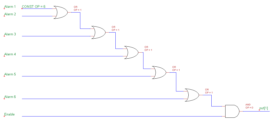

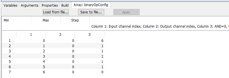

6-input OR gate + AND
You can add an AND term onto the end to act as a global qualifier, such as a master enable for a variety of alarm sources (OR).
![](../../__attachments/3170895397/att_16_for_3037134876.png?inst-v=326272e9-cc04-48f3-a51a-5d633eb0a230)
Figure 24. Argument settings for 6-OR+AND
![](../../__attachments/3170895397/att_17_for_3037134876.png?inst-v=326272e9-cc04-48f3-a51a-5d633eb0a230)
Figure 25. Array settings for 6-OR+AND
![](../../__attachments/3170895397/att_18_for_3037134876.png?inst-v=326272e9-cc04-48f3-a51a-5d633eb0a230)
Figure 26. Confirm settings
![](../../__attachments/3170895397/att_28_for_3037134876.png?inst-v=326272e9-cc04-48f3-a51a-5d633eb0a230)
Figure 27. Equivalent logic diagram
