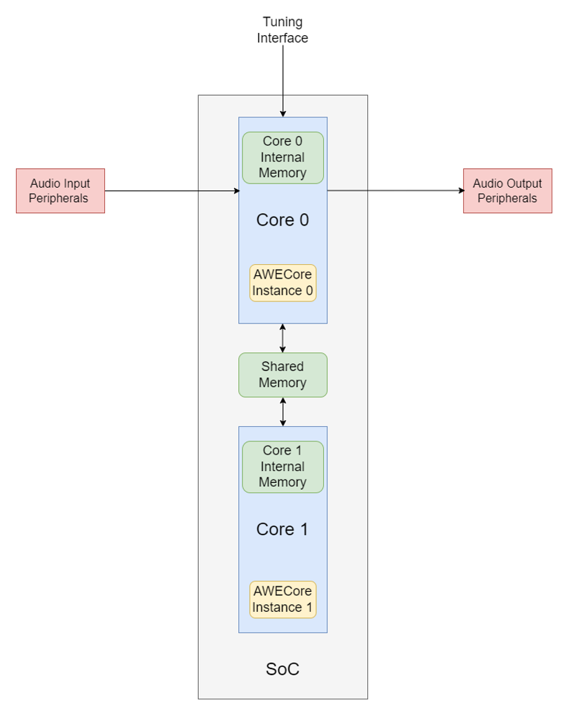

Standard SoC Architecture Example
Consider a standard multicore SoC architecture:
![](../../__attachments/3343844843/image-20230207-202121.png?inst-v=afeb83b1-861e-46b8-b4de-1c642321bb7f)
Figure 1. Generic Audio SoC Architecture
In this SoC architecture, there are two separate processing cores.
Core 0 has:
Access to the tuning interface
Access to all Audio I/O peripherals
Access to shared memory region
Its own internal memory region
Core 1 has:
In this typical multicore SoC architecture, an instance of AWE Core can be placed on each core. The shared memory of the SoC is utilized by AWE Core to communicate between the two instances, as well as buffer audio data between instances. AWE Core handles all data exchange between instances; no user protocol or software needs to be written to facilitate.

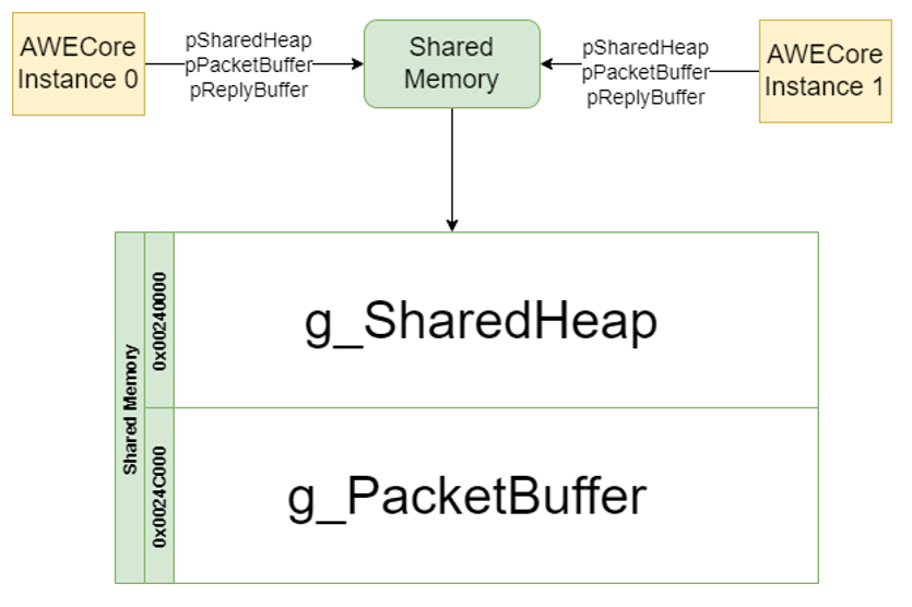

Initializing Shared Heap
To facilitate multi-instance with AWE Core, each AWE Core instance requires an initialization of the shared heap.
/*------------------MULTI-INSTANCE SUPPORT------------------*/
/** AWE Core shared memory definitions.
* OPTIONAL if using only single-instance AWE Core.
/** The shared heap. */
volatile UINT32 *pSharedHeap;
/** The shared heap size. */
UINT32 sharedHeapSize;
The shared heap is a contiguous section of memory which occupies the same physical address space for all AWE Core instances.
![](../../__attachments/3343844843/image-20230207-202341.png?inst-v=afeb83b1-861e-46b8-b4de-1c642321bb7f)
Figure 2. Shared Address Space Architecture
pSharedHeap points to this contiguous segment of memory. Every AWE Core instance in use is required to point to the same shared memory region address space. For this reason, shared heap must be placed in a shared memory region.
The size of this region is provided to AWE Core using sharedHeapSize.

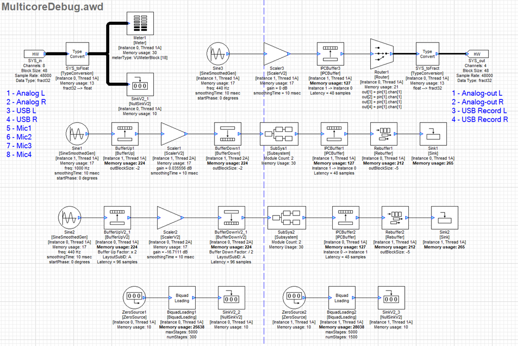

Creating multi-instance designs in Audio Weaver
Audio Weaver provides a single design canvas which can place modules on any instance. Audio data can be routed between instances in one design file, which allows users to move processing loads seamlessly to available cores on an embedded target. The below example canvas has processing distributed over two AWE Core instances residing on two different processing cores.
![](../../__attachments/3343844843/image-20230224-212444.png?inst-v=afeb83b1-861e-46b8-b4de-1c642321bb7f)
Figure 3. Multi-instance Canvas

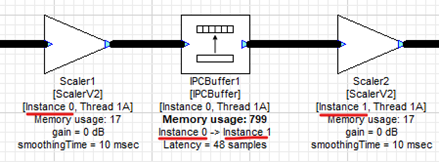

The instance ID of a module is propagatable between modules, which means that if the output of a module on instance ID 0 is routed to another module, that second module will inherit the instance ID and process on instance ID 0 as well.
There are two ways of changing the instance ID of a module.
Using the IPCBuffer module
(Source modules only) Modify the clockDivider field of a module
IPCBuffer Module
The IPCBuffer module is a simple module which takes an input data wire, and using a tunable parameter targetInstance, directs this data to a new instance. Modules connected to the output of the IPCBuffer module will inherit this new instance ID.
![](../../__attachments/3343844843/image-20230207-203019.png?inst-v=afeb83b1-861e-46b8-b4de-1c642321bb7f)
Figure 5. IPCBuffer Example

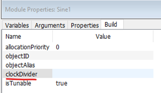

To reach the clockDivider field, right-click on the module and select View Properties.
In the bottom pane that appears, select the Build tab, and locate the clockDivider field.
![](../../__attachments/3343844843/image-20230207-203127.png?inst-v=afeb83b1-861e-46b8-b4de-1c642321bb7f)
Figure 7. clockDivider field
