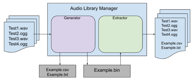

This application note describes the usage of Audio Library Manager Tool alongside Audio Weaver Designer and demonstrates its uses. It is an application with a GUI to easily create wave flash file systems that contain audio files to be played on a target hardware or to be tested on a native target. This is a standalone application and is independent of any underlying software to create the Binary file. This is an upgrade from the previous ‘Wave Library Generator’ as it now both generates binary as well as extracts files from a binary.

The Audio Library Manager can be used both as a generator and as an extractor as shown below

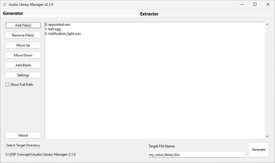

Audio Library Manager - Generator Side
Open the Audio Library Manager, Add the audio files by ‘Add File(s)’ button as per the order you require. Select the Target Directory by browsing to the target folder. Type in ‘Target File Name’ as shown in the figure below. Press Generate.
Figure 1: Audio Library Manager Window (Generator Side)

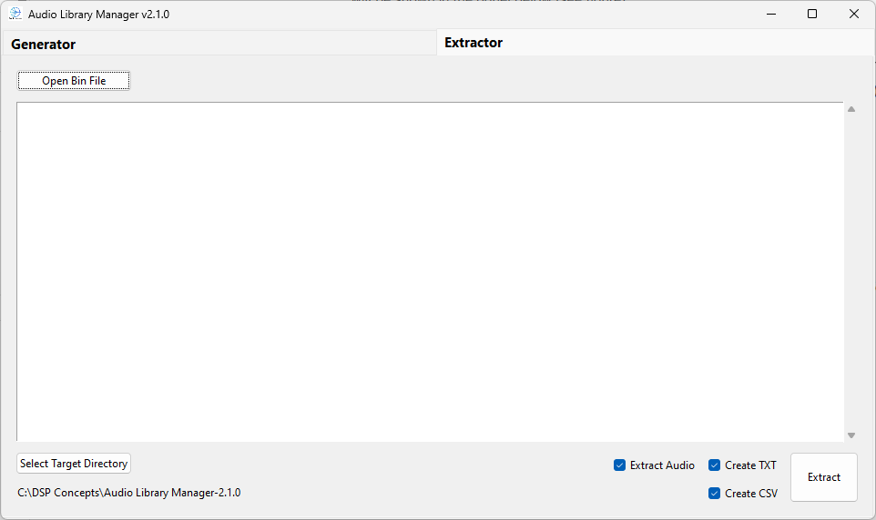

Audi Library Manager - Extractor Side
The extractor side of the Audio Library Generator takes in a Binary file and extractors all the information and data within the file according to the user selection.
Figure 4: Audi Library Manager - Extractor Side

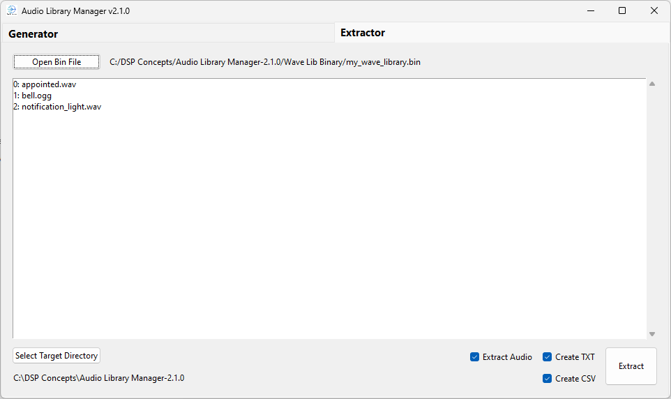

Press the ‘Open Bin File’ button to select a binary file for extraction. The Extractor window will show the wav/ogg files in the .bin file. Depending on user requirement, please select the check boxes:
Extract Audio - audio files shall be extracted
Create Txt - file documenting the audio files that were included in the wave library
Create CSV - file containing the names of the audio files in the wave library in uint32 format
Figure 5: Selected Binary File for Extraction

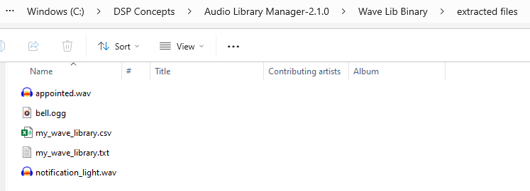

Figure 6: Extracted Files
