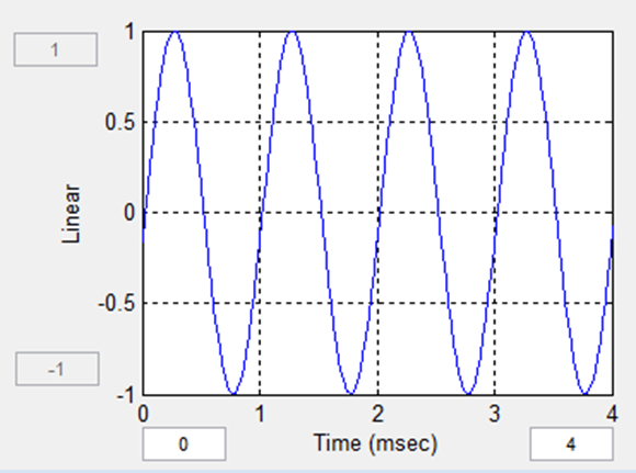

SineGen / SineSmoothedGen ![]() | ![]() |

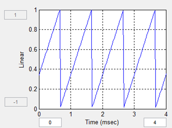

Sawtooth ![]() | ![]() |

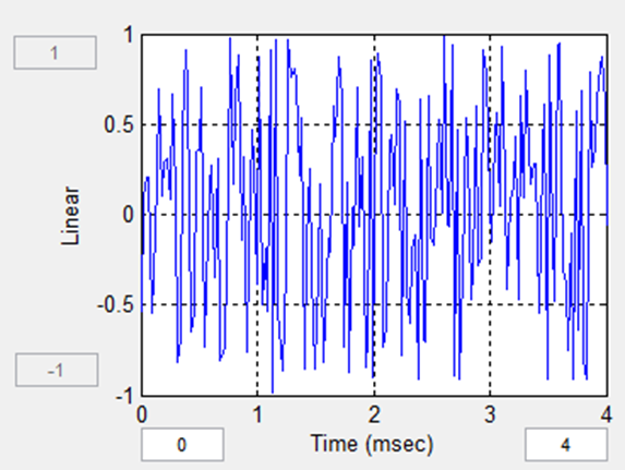

WhiteNoise ![]() | ![]() |

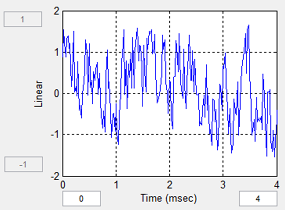

PinkNoise ![]() | ![]() |

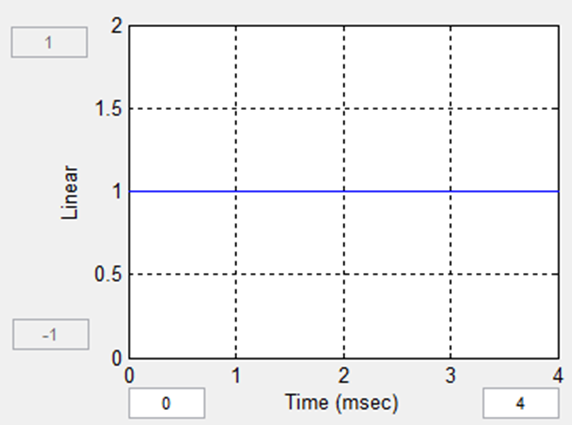

DCSource (outputs one steady value) ![]() | ![]() |

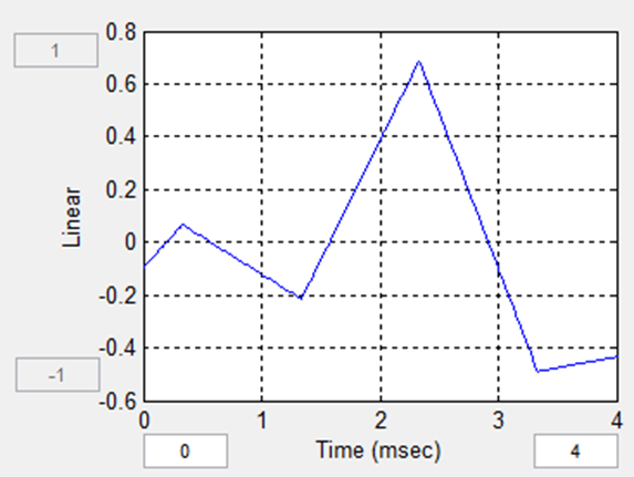

Randi ![]() | ![]() |
