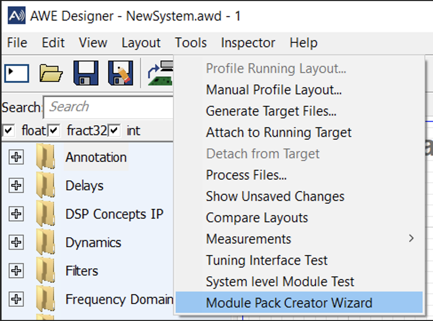

To create a new custom module pack, open Audio Weaver Designer. Select “Tools->Module Pack Creator Wizard”
![](../../__attachments/2878901085/Screen%20Shot%202022-12-02%20at%201.51.49%20PM.png?inst-v=afeb83b1-861e-46b8-b4de-1c642321bb7f)

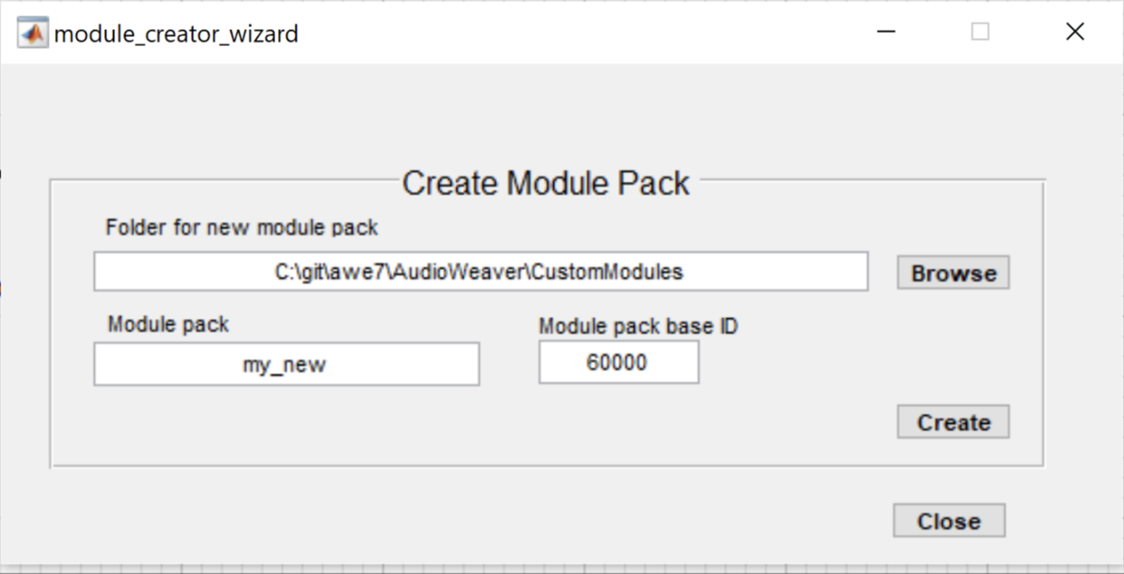

The following dialog is launched:
![](../../__attachments/2878901085/Screen%20Shot%202022-12-02%20at%202.02.27%20PM.png?inst-v=afeb83b1-861e-46b8-b4de-1c642321bb7f)
Browse to the folder where the custom module pack folders should be created, enter the desired module pack base name, and enter a module pack base ID of 60000 or greater up to 63486.
Contact DSP Concepts to allocate a block of class IDs for a new module pack.

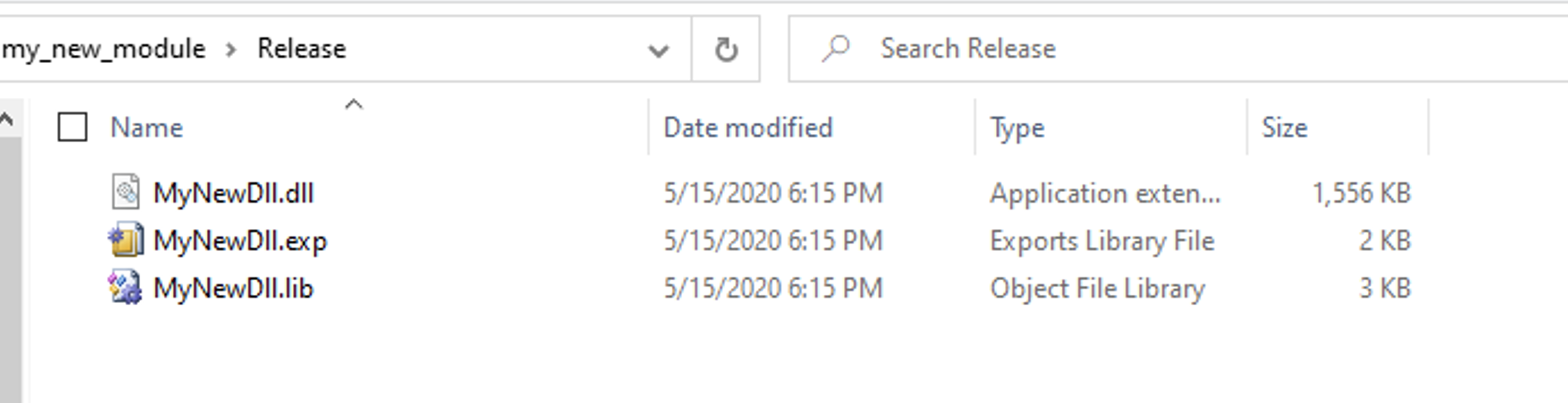

Creating the Windows DLL requires two separate Microsoft Visual Studio projects: one to create a static library and one to create the DLL. The wizard creates a Microsoft Visual Studio Solution file (.sln) with these projects. To create the module pack DLL, build the solution for x86 using Visual Studio. The module pack DLL and .lib files will be created in the Release or Debug folders of the module pack folder as shown below:
![](../../__attachments/2878901085/Screen%20Shot%202022-12-04%20at%2010.09.53%20AM.png?inst-v=afeb83b1-861e-46b8-b4de-1c642321bb7f)
Build the .sln in x86 Release mode, and make sure the .dll file is copied to the Bin/win32-vc142-rel folder of the Designer installation. Once AWE Server is restarted, do Target → List Modules. If the new module pack is found by AWE Server, then the new module should be listed with the appropriate class ID as “60601 ModuleMyNew” is below:
![](../../__attachments/2878901085/Screen%20Shot%202022-12-04%20at%2010.10.33%20AM.png?inst-v=afeb83b1-861e-46b8-b4de-1c642321bb7f)

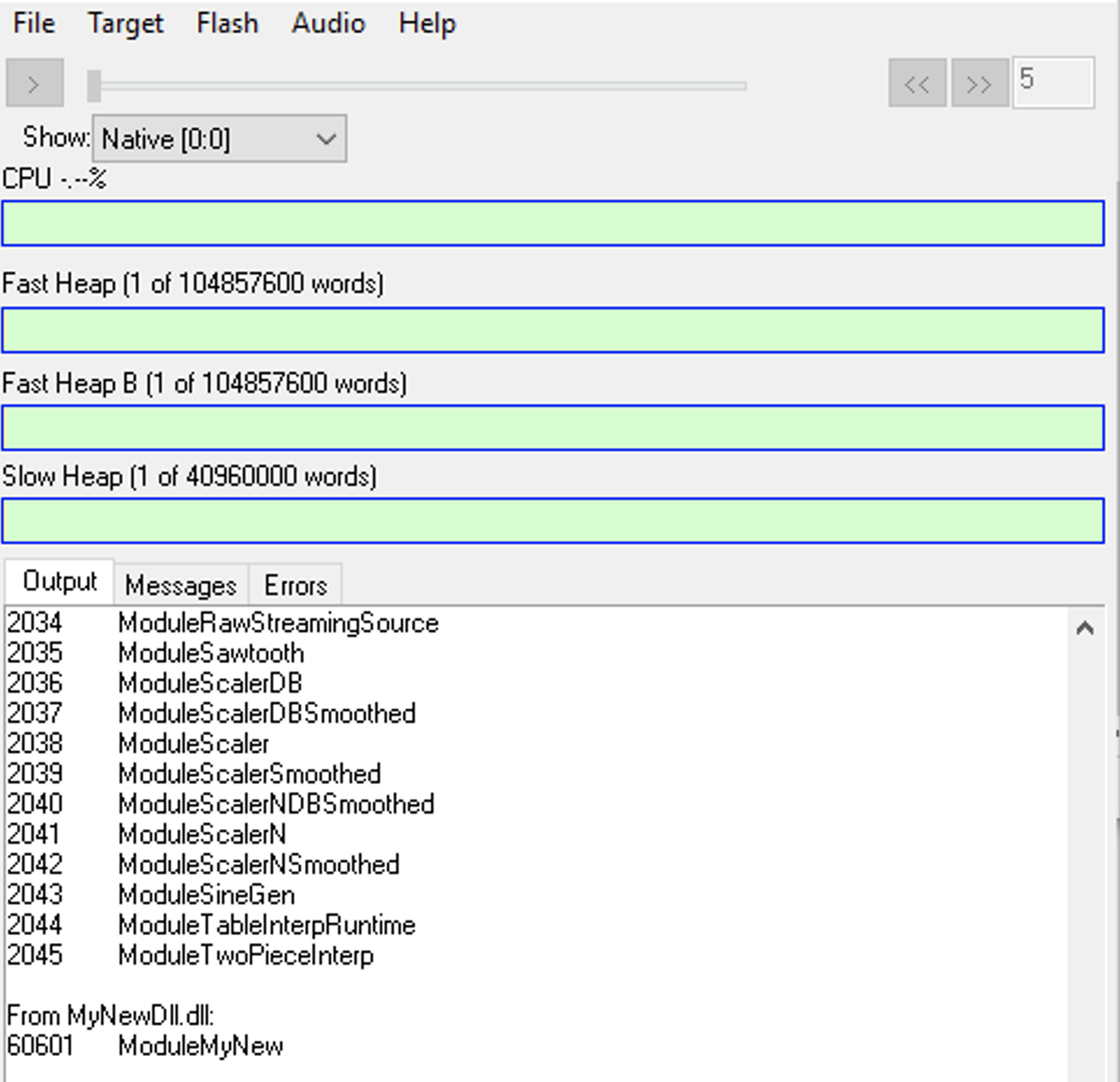

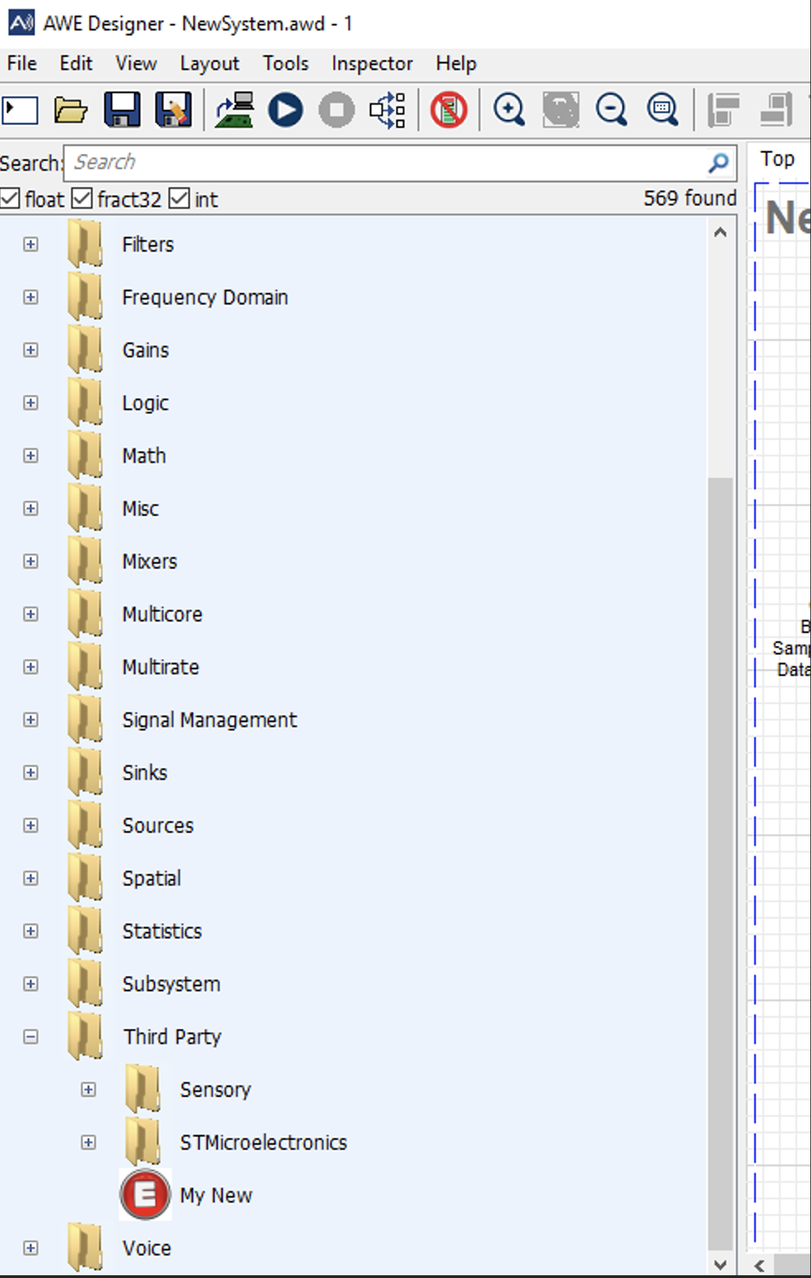

Next, start Designer and expand the “Third Party” category in the module palette on the left hand side. The new module should appear as below if the new module pack directory has been added to the Designer Module Path.
![](../../__attachments/2878901085/Screen%20Shot%202022-12-04%20at%2010.11.54%20AM.png?inst-v=afeb83b1-861e-46b8-b4de-1c642321bb7f)
![](../../__attachments/2878901085/Screen%20Shot%202022-12-04%20at%2010.12.15%20AM.png?inst-v=afeb83b1-861e-46b8-b4de-1c642321bb7f)

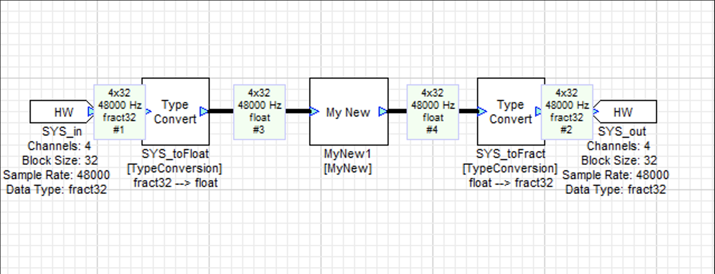

The new module can then be dragged out onto the canvas and tested with a simple layout. Module documentation can be viewed by right clicking the module and selecting ‘Help’.
