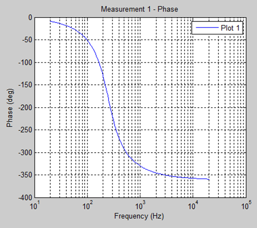

Allpass Pair
The Allpass Pair module creates a pair of allpass filters with the special property that their sum and difference form a doubly complementary highpass-lowpass filter pair. When used in conjunction with the Sum and Difference module (available in the Math folder) this Allpass Pair module can be used to construct more complex structures such as N-way crossovers and filter banks. The following design mixes one channel of white noise into two “bands” of white noise using this technique. The sink is an FFT showing the frequency response of the signal.

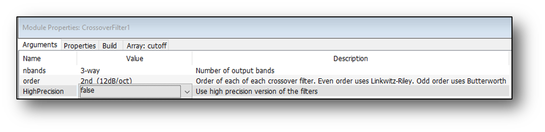

Crossover Filter
A crossover is a special type of filter that splits a signal into multiple bands, while sustaining a total gain of 0 dB. It will boost the level of one frequency band as the other drops to compensate to 0 dB gain. This behavior is shown in the figure below.
Crossovers are used in loudspeaker applications to separate signals into different frequency bands to be output via woofers, mid-range, and tweeter speakers. They are implemented using ButterworthFilter (odd-order) or Linkwtiz-Riley (even-order) filters. Crossover filters can be made manually using individual filters. By cascading filters and applying an allpass filter during other lane filter stages (shown below), more crossover points can be added and the signal split into more frequency bands, while retaining the unity gain property.
Alternatively, use the crossover module which contains all of the needed filters. The Crossover Filter module allows the user to set the type of filter, number of output bands, and filter order, specified in the module’s properties. Crossovers are used for separating different frequency bands of a signal. The example below demonstrates a crossover module being used to split a signal into a high band above 250 Hz and a low band below 250 Hz. The sum of the levels of the two bands is always 0 dB. As the input frequency changes near 250 Hz, one channel’s level drops and the other smoothly increases to compensate to 0 dB.
This is the same behavior as using two ButterworthFilter filters:
allows the configuration of 2 or more output channels. The module will then be drawn with 3 output pins. The top pin is the low frequency; the center pin is the mid-range, and the bottom pin is the high frequencies. The inspector shows two cutoff frequencies: between the low and mid-range; and between the mid-range and high frequencies. For example, if implementing a 3-way loudspeaker crossover, configure it as:

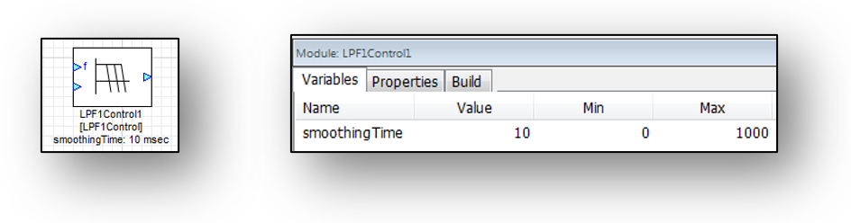

LPF Control
The LPF Control module is a time varying first order low pass with smoothly varying frequency based on the input pin.

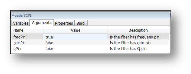

The SOFControl filter is built upon the SecondOrderFilterSmoothed module. It has a fixed filterType which is specified on the inspector. Under module arguments, specify which of the filter design parameters should be obtained via input pins:
Parameters which aren’t specified by input pins are specified via the variables and properties tab. The SOFControl module uses deferred processing to compute the filter coefficients. That is, the design equation is not executed every block. Rather, when the control data on the input pin changes, the module sets a bit in its instance structure which causes the design function to be called from non-real-time code. This reduces the peak CPU load at the expense of having a slower update rate. In typical applications, the module will update every few 10s of milliseconds. If updating needs to happen more quickly, then use the FOFControl module or the ParamSet module coupled with a SecondOrderFilterSmoothed module.

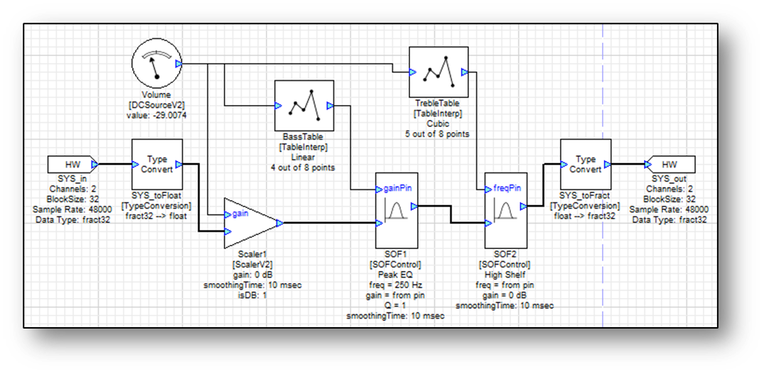

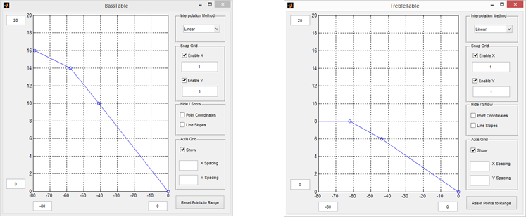

A very common use of the SOFControl module is within a perceptual volume control. As the volume of the system is reduced, overall spectral balance should be maintained. Due to the sensitivity of the human auditory system, low frequencies and high frequencies appear to drop off more quickly than mid frequencies. Thus, to maintain the overall spectral balance, boost low and high frequencies as the volume level decreases. The VolumeControl module accomplishes this with a fixed boost table. For finer control over the boost, use a TableInterp module together with a SOFControl filter as shown below. The control signal “Volume” specifies the listening level and ranges from 0 (loud) to -80 (soft). The lookup tables convert the Volume setting into low frequency and high frequency boosts which are applied using the SOFControl module. The low frequency SOFControl module implements a peaking filter at 40 Hz and the gain is taken from the control pin. The high frequency SOFControl module implements a high shelf in which the gain is taken from the control pin.
Example showing use of the SOFControl module in a table driven loudness control
Lookup tables used in the table driven loudness control example. The left table converts the volume setting into a bass boost and the right table does the same for the high frequency adjustment.

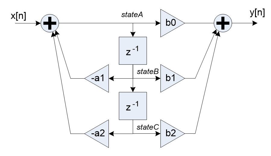

Audio Weaver contains a variety of Biquad filters for equalizing audio. Some filters require raw coefficients (such as Biquad or BiquadCascade) while others contain built-in design equals (such as the SecondOrderFilter or ButterworthFilter). These filters are implemented using a Direct Form 2 (DF2) structure:
All Biquad filters including the DF2 have 5 coefficients. The advantage of the DF2 structure is that it requires only 2 state variables per filter as compared to 4 state variables for the DF1 structure.
These Biquad filters are implemented using floating-point arithmetic and are generally fine for most audio applications. Floating-point arithmetic, though, is not a panacea for all numerical issues and these filters can still suffer from quantization noise. The noise manifests itself as low-level noise correlated with the level of the input signal. Quantization noise is exacerbated by high sampling rates (96 kHz and above) and by having poles very close to the unit circle and this usually arises when making very low frequency EQ changes.

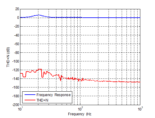

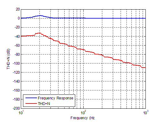

Here is an example of the benefits of the high precision filter. The system in the example has a peaking filter at 20 Hz with a gain of 6 dB and a Q of 2 and operates at a 48 kHz sample rate. The total harmonic distortion and noise (THD+N) for different input frequencies is plotted below. First for standard Biquad filters
And now with a high precision filter, notice that the noise floor is reduced significantly – by up to 90 dB at low frequencies.
For the interested reader, this measurement is performed by passing sine waves of different frequencies through the filter. Apply a notch filter at the output which removes the sine wave and then measure the RMS energy in the residual. This residual energy equals the THD+N. The measurement is repeated for many different frequencies and the plot reflects the measured THD+N at each input frequency.

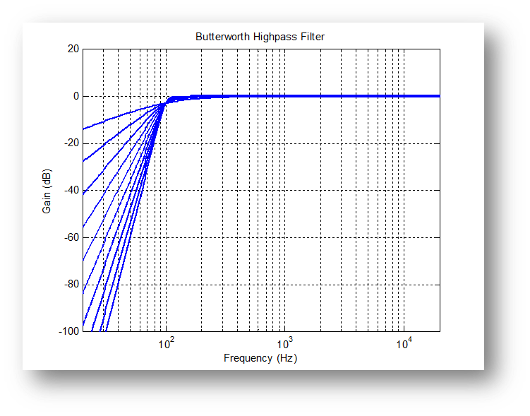

ButterworthFilter

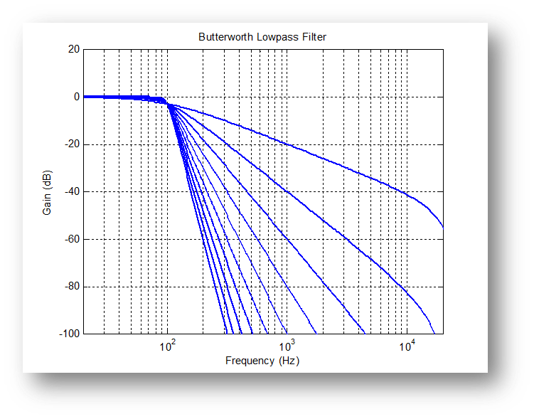

This module implements lowpass, highpass, or allpass filters using a Butterworth design. The filters have a gain of 0 dB in the passband and are then monotonically decreasing in the stopband. The filter order is specified under module properties and ranges from 1st order (6dB/octave) to 10th order (60dB/octave). The filter order can only be changed in Design mode. Specify the filter type on the inspector (lowpass, highpass, or allpass) as well as the cutoff frequency, in Hz. Since these parameters are on the inspector, the filter type and cutoff frequency can be changed at run-time. Unfortunately, the ButterworthFilter does not have coefficient smoothing and there may be discontinuities when coefficients are updated.
Butterworth lowpass filter frequency response as a function of filter order. The filter order goes from 1st order (least steep line) to 10th order (steepest line). The cutoff frequency is 100 Hz and the sample rate is 48 kHz
Butterworth high filter frequency response as a function of filter order. The filter order goes from 1st order (least steep line) to 10th order (steepest line). The cutoff frequency is 100 Hz and the sample rate is 48 kHz

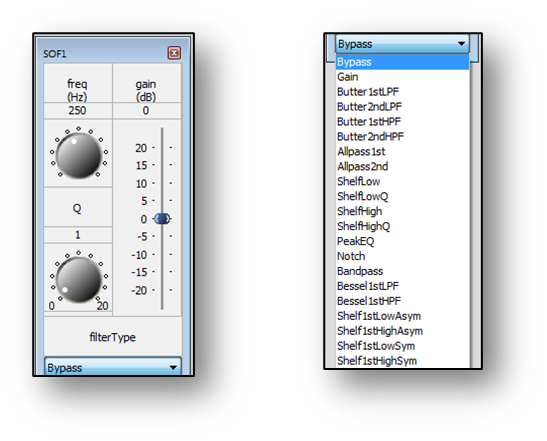

This module is the most frequently used filter among all of the Audio Weaver modules. It implements a 2nd order Biquad filter and includes design equations for 20 different filter types. The filter type and high-level design parameters (frequency, gain, and Q) can be changed at run-time using the inspector:
Depending on the filter type, some parameters are not used. See the table below for the filter types available and which control parameters are applicable.

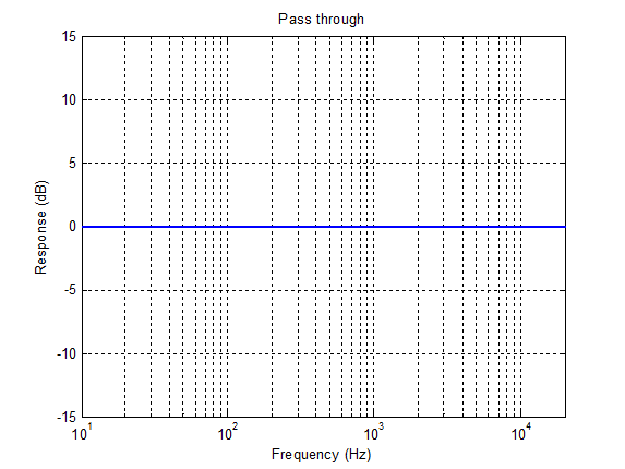

Pass Through filterType = 0
Applicable parameters: none.
Biquad coefficients are set to b0=1, b1=0, b2=0, a1=0, and a2=0. The filter runs and consumes processing but the output equals the input. |

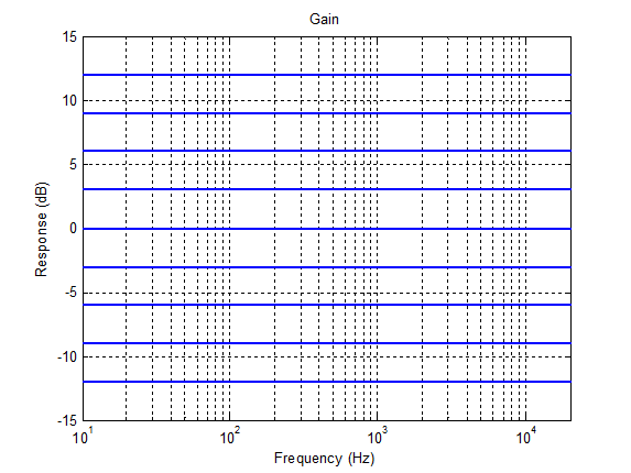

Gain filterType = 1
Applicable parameters: gain
A simple gain with coefficients set to b0=undb20(gain), b1=0, b2=0, a1=0, and a2=0 | ![]() |

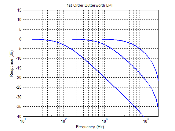

1st order Butterworth lowpass filter filterType = 2
Applicable parameters: freq | ![]() |

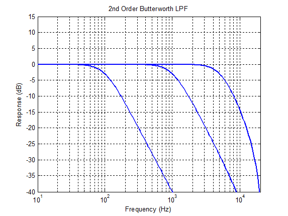

2nd order Butterworth lowpass filterType = 3

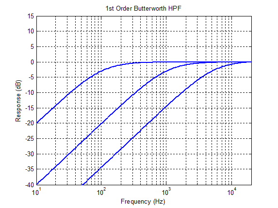

1st order Butterworth highpass filterType = 4

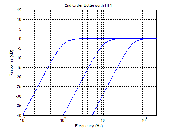

2nd order Butterworth highpass filterType = 5

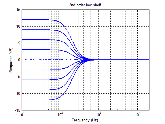

2nd order low shelf filterType = 8
Applicable parameters: freq and gain
Use as a low frequency tone control | ![]() |

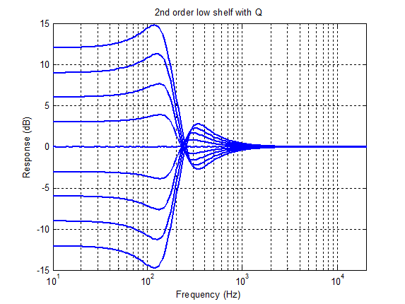

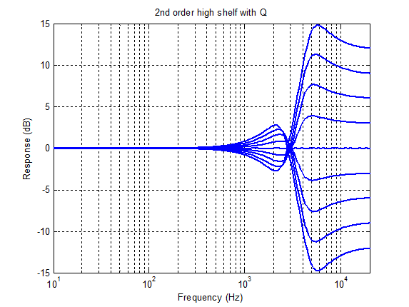

2nd order low shelf with Q filterType = 9
Applicable parameters: freq, gain, and Q | ![]() |

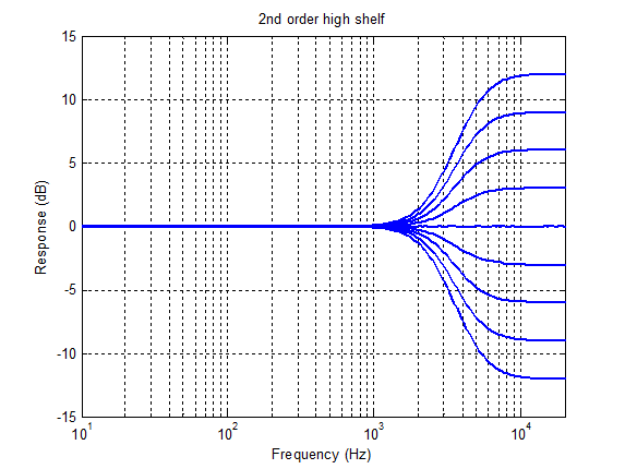

2nd order high shelf filterType = 10
Use as a high frequency tone control

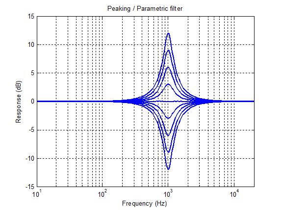

2nd order peaking / parametric filterType = 12
Commonly used for generic equalization since it has controllable frequency, gain, and Q settings. | ![]() |

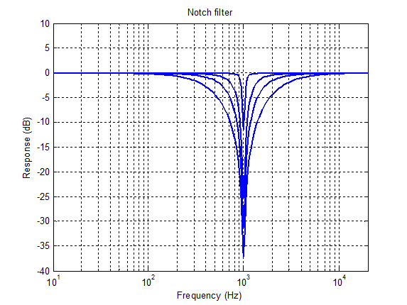

2nd order notch filterType = 13
Applicable parameters: freq and Q | ![]() |

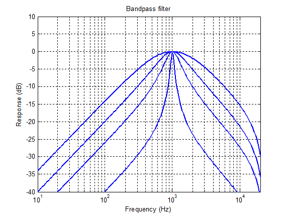

2nd order bandpass filter filterType = 14

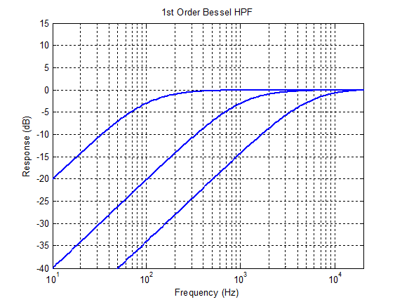

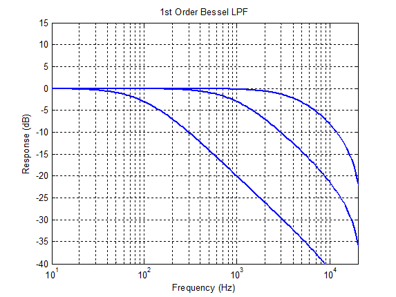

1st order Bessel lowpass filter filterType = 15

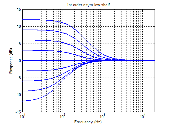

1st order asymmetrical low shelf filterType = 17
Applicable parameters: freq and gain | ![]() |

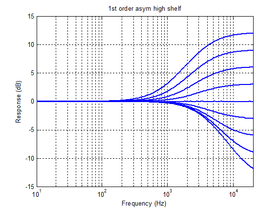

1st order asymmetrical high shelf filterType = 18

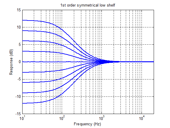

1st order symmetrical low shelf filterType = 19

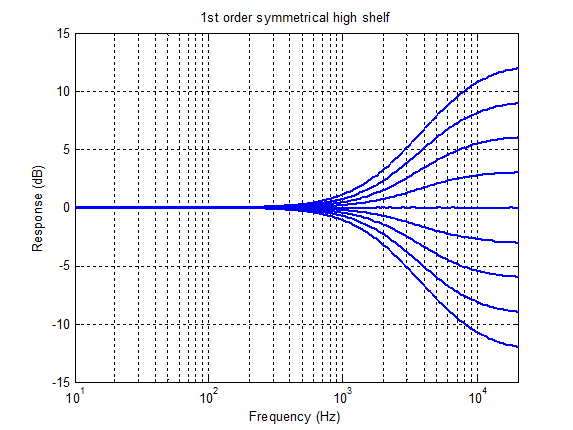

1st order symmetrical high shelf filterType = 20

Low/high shelf filter and low/high shelf filter Q are identical if Q is set to 0.707 (√0.5).

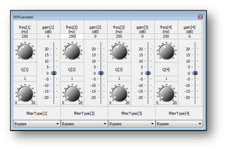

Second Order Filter Smoothed Cascade
This module contains several SecondOrderFilterSmoothed modules in series. This can be used to implement a more complicated EQ with only a single module. Under module properties, specify the number of stages of filtering. If the number of stages is set to 1, then this module is equivalent to the SecondOrderFilterSmoothed module. When there are multiple stages, the inspector expands as shown right:
