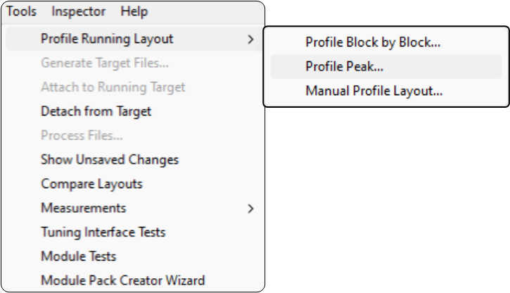

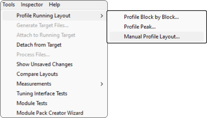

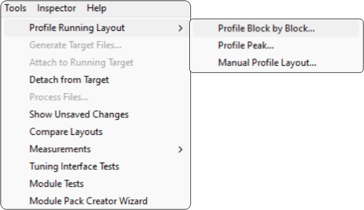

To profile a running .awd in real time, navigate to the ‘Tools > Profiling Running Layout’ menu in the Audio Weaver Designer toolbar while in Tuning Mode:
Profile Running Layout
There are two options for profiling a running .awd layout in real time:

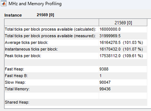

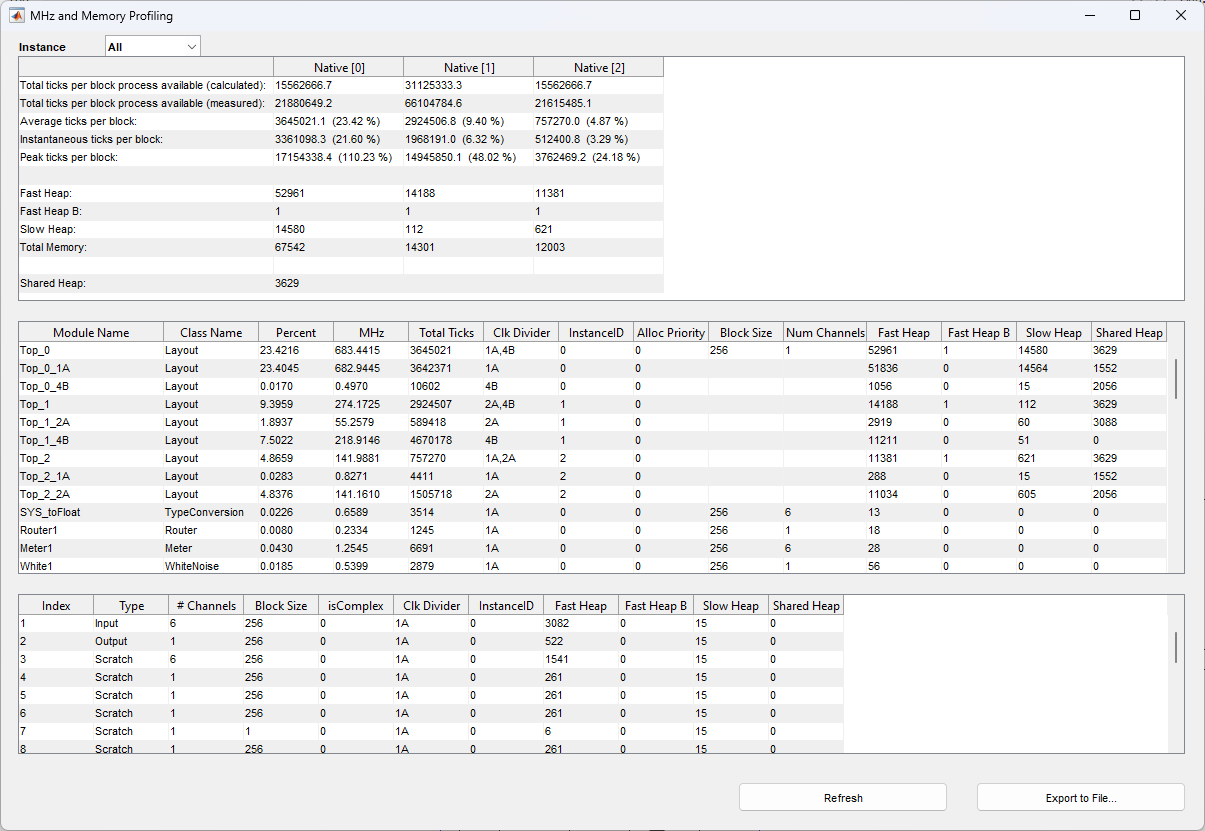

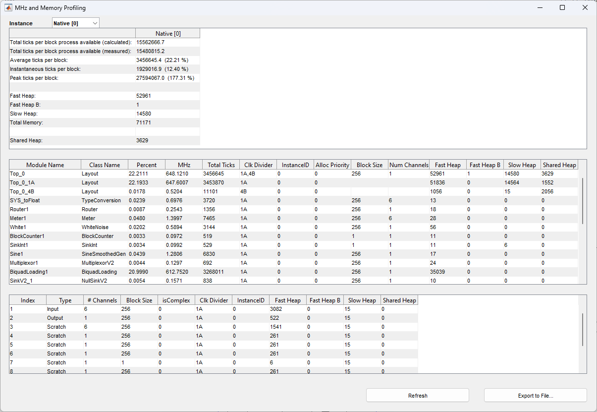

When selecting the ‘Profile Block by Block’ real time profiling option, Audio Weaver will run complete MHz and Memory profiling on the entire audio system signal flow (.awd) and display the profiling information in a pop-up window. The ‘Tick’ mentioned here is the time measured in terms of CPU clock cycles. It can be measured as Tick = (1/CPU Clock Frequency). MHz is the Million Instructions Per Second (MIPS) of the system.
Profile Block by Block Window
In the upper right-hand corner of the profiling window provides the following information:
Total ticks per block process available (calculated and measured)
Average ticks per block
Instantaneous ticks per block
Peak ticks per block
Total memory usage of the system
Shared heap memory for multi-instance architectures
Profile Block by Block Window (intentional CPU overflow)
Profile Block by Block Terminology
The following table describes each field:
Field | Definition | Unit |

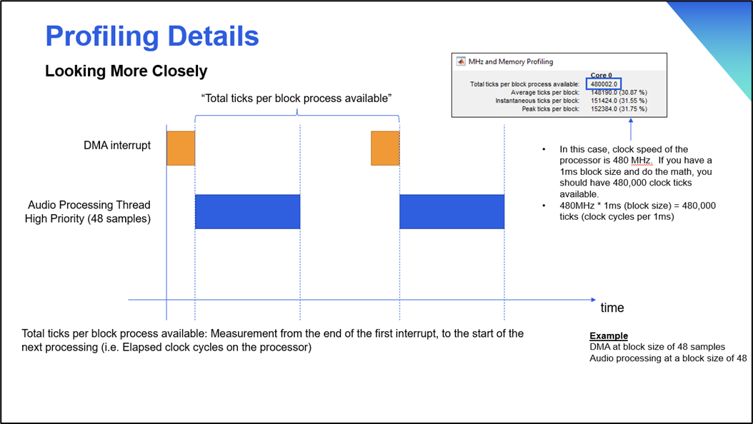

Total ticks per block process available | Measurement from the end of the CPU first interrupt This is an especially important number to check when you are bringing up new hardware. The value shown here should be close to: (Processor Speed) x (Block Size of Processing) / (Sample Rate) If this doesn’t match, then there could be a mismatch in your processor speed, the audio sample rate, or the underlying “fundamental block size” of your implementation. Lastly, there are two separate line items for ‘Total ticks per block process available’.
Both of these units should nearly match, however be aware that if there are CPU overflows (>100% processing load), the ‘Measured’ metric will be doubled. In this scenario, since the audio pump is not completed during the current block of processing, the measured metric would include the next block as well. | CPU clock cycles |
Average ticks per block used | Average of CPU clock cycles per block of audio data | CPU clock cycles |
Instantaneous ticks per block used | CPU clock cycles required to process the last block of audio. This is the instantaneous measurement without smoothing. This number will change every time you profile. | CPU clock cycles |
Peak ticks per block used | Peak instantaneous CPU clock cycles consumed when processing a block of audio data. This is a “sticky measurement” and shows the peak value since system startup. If you reprofile, then it will reset this value. | CPU clock cycles |
Fast Heap | Memory usage from the memory allocated in the Fast Heap | Words |
Fast Heap B | Memory usage from the memory allocated in the Fast Heap B | Words |
Slow Heap | Memory usage from the memory allocated in the Slow Heap | Words |
Total Memory | Fast Heap + Fast Heap B + Slow Heap | Words |
Shared Heap | Memory usage from the allocated Shared Heap | Words |
Heaps At initialization time, memory to be used by the AWE Core instance for signal processing is allocated. The AWE Core refers to this memory as the heap. By default, AWE Core supports three heaps for which the BSP is responsible for allocating storage. Most commonly, heaps are allocated statically as large arrays. The heaps are:
To calculate Memory in MB: ((Total Heap Memory) * 4)/1000000 | ||

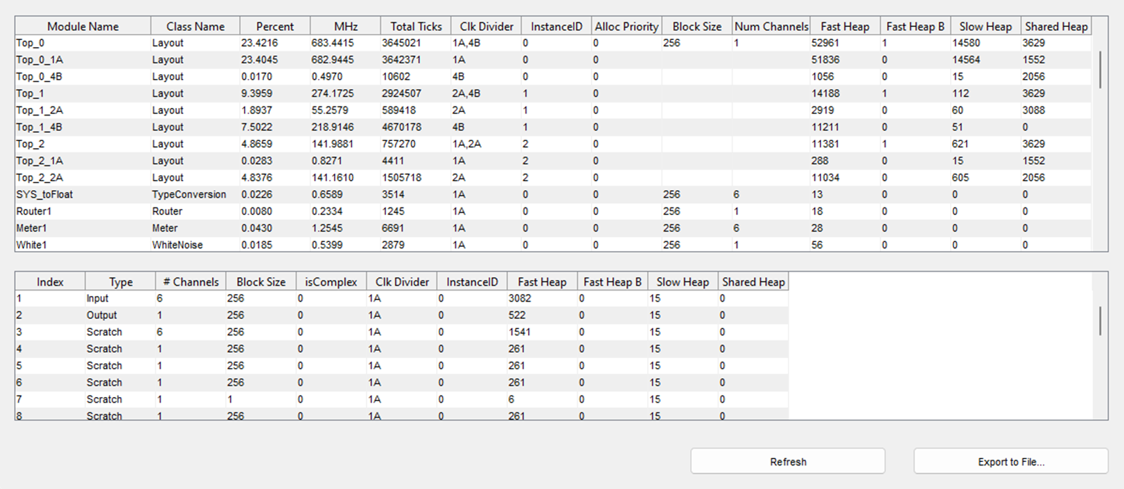

The rest of the profiling window provides profiling information for each individual module and wire (audio buffer) in the running .awd layout:
Profile Block by Block Individual Module & Wire Profiling (All Audio Weaver Instances)
Field | Description |
Module Name | Name of the specific module in this layout. |
Class Name | Class to which the module belongs. |
Percent | Percent of the CPU load taken by this module or subsystem. |
MHz | Percent times the Total ticks per block process available. |
Total Ticks | Number of clock ticks which were measured for this module. |
Clk Divider | Clock dividers assigned in this module or subsystem. |
InstanceID | Assigned Instance ID |
Alloc Priority | Assigned allocation priority |
Block Size | Module’s block size |
Num Channels | Number of channels |
Fast Heap | Allocation to Fast Heap |
Fast Heap B | Allocation to Fast Heap B |
Slow Heap | Allocation to Slow Heap |
Shared Heap | Allocation to Shared Heap |

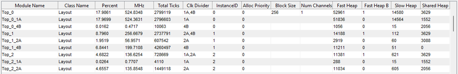

The ‘Top_0’ Module Name line item contains profiling information for the entire .awd layout’s processing. In a multi-instance architecture, aggregate profiling information for each discrete Audio Weaver instance is labeled as ‘Top_<AWE Instance #>’. If the .awd utilizes multiple audio processing threads, aggregate profiling information for each discrete thread is labeled as ‘Top_<AWE Instance #>_<Thread ID>’:
Top Profiling for AWE Instances and Threads
For more information on multi-threading in Audio Weaver, see the Threading and Clock Dividers Application Note.

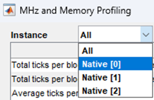

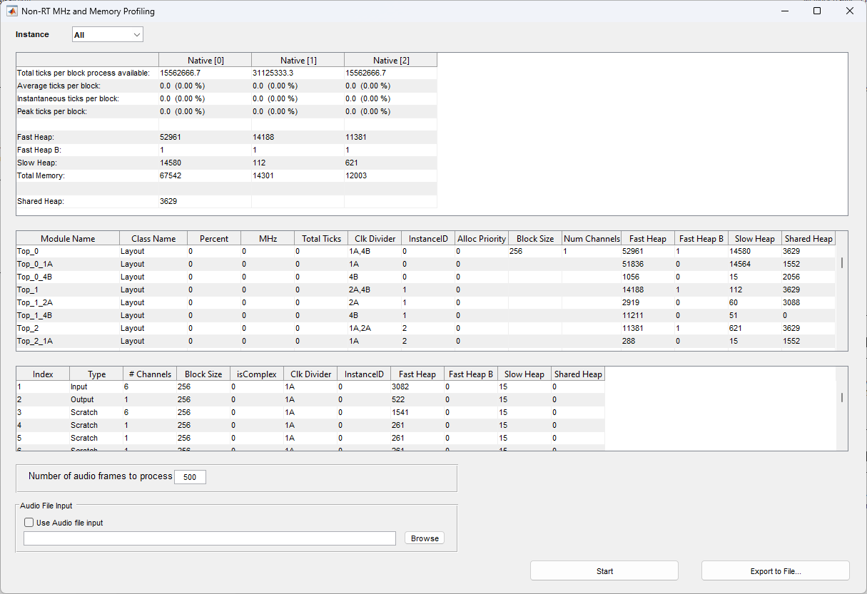

In a multi-instance architecture, by default the profiling pop-up window displays profiling information for all of the Audio Weaver instances used:
Block by Block Processing: All AWE Instances

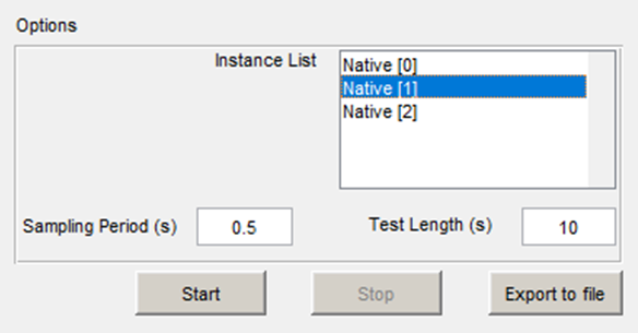

To display profiling information for only one specific Audio Weaver instance, you can do so by selecting the desired Audio Weaver instance from the Instance drop down menu in the upper left-hand corner:
Block by Block Profiling: AWE Instance Selection
Block by Block Profiling – Discrete AWE Instance

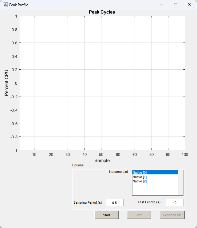

When selecting the Profile Peak real time profiling option, the Peak Profile Window will pop up:
Profile Peak
Profile Peak Window

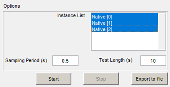

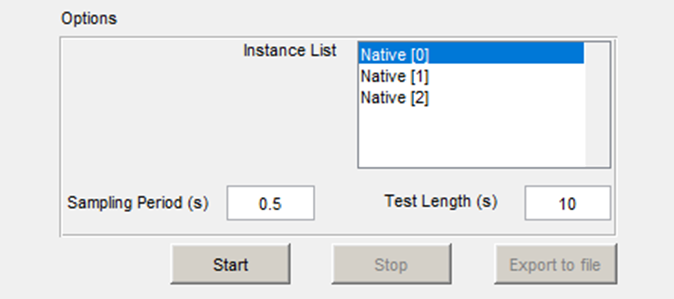

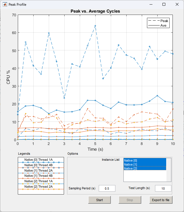

As discussed above, the ‘Sampling Period’ and ‘Test Length’ fields must be entered in order to run the peak profiling. The time unit for both fields are seconds, and the default values are 0.5s sampling period and 10s test length. When ready to start the peak profiling, simply click the ‘Start’ button.

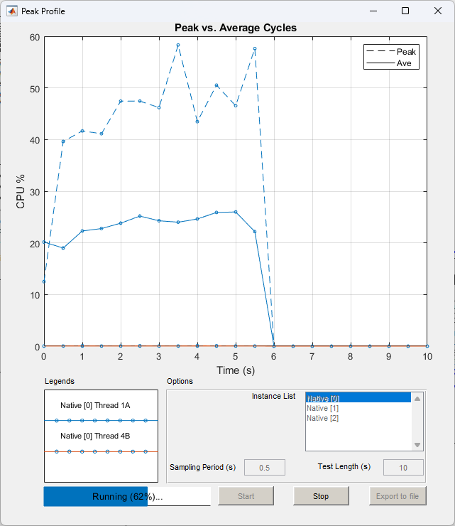

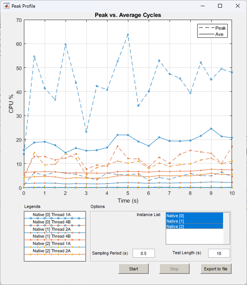

The Peak Profile window will update in real time as the profiling is executed. You can click the Stop button at any time during the profiling, otherwise the peak profiling will complete at the end of the specified length of test:
Peak Profiling in Progress
The ‘Peak vs Average Cycles’ graph at the top of the Peak Profiling pop-up window displays peak and average CPU usage percentages of the processor Audio Weaver is running on. If the running .awd has a multi-instance architecture or contains multi-threading, multiple profiling measurements for each Audio Weaver instance and thread will also display. The x-axis is time in seconds and the y-axis is CPU percentage:
Peak Profiling

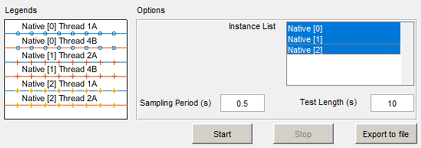

The bottom portion of the Peak Profiling pop-up window displays a Legend for the Peak vs Average Cycles line graph and an Instance List to select which Audio Weaver instance profiling measurements to display:
Peak Profiling Legend and Instance List

To Manual Profile an .awd layout, navigate to ‘Tools > Profile Running Layout > Manual Profile Layout’ in the Audio Weaver Designer toolbar while in Tuning Mode:

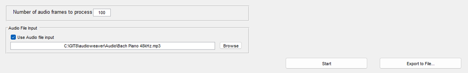

At the bottom of the Non-RT MHz and Memory Profiling pop-up window, set the Number of audio frames (blocks) to process and an audio file to be used as input audio data:
Manual Profile Settings
If no audio file is used as input audio data, the Manual Profiler will use audio data from the specified source selected in the Layout Properties.

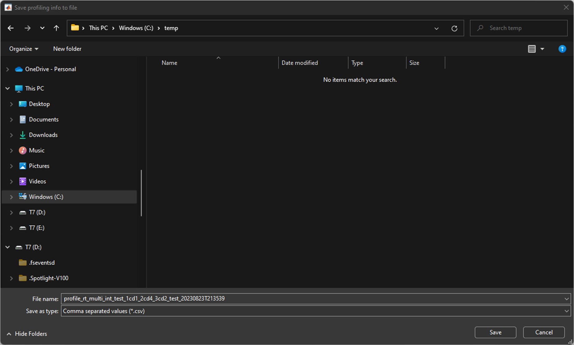

Once the ‘Export to File’ button is clicked, users are prompted to choose a file name and path for the profiling data export file:
Export Profiling CSV File Name and Path

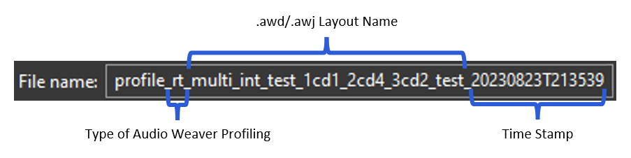

The default profiling .csv file name follows this naming convention:
Default CSV File Name

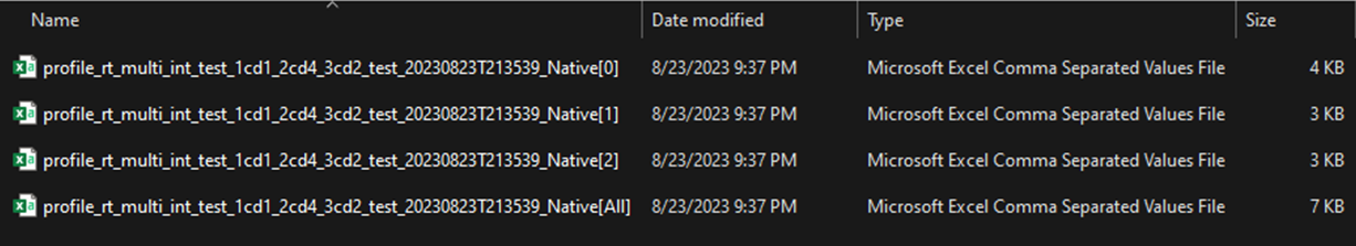

For multi-instance architectures, every Audio Weaver profiling utility enables users to export either profiling data for all instances or individual profiling data for a selected Audio Weaver instance:
Block by Block and Manual Profiling – Instance Export Option
Peak Profiling – Instance Export Options

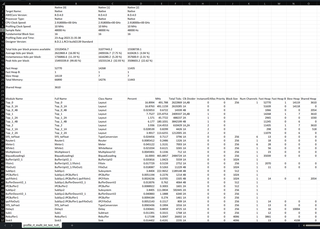

For block by block and manual profiling of multi-instance architectures, if profiling data for all instances are selected for export, Audio Weaver will generate one aggregate profiling CSV file and individual CSV files for each Audio Weaver instance in the system:
CSV Export for All Audio Weaver Instances
Once exported and saved, users can open the .csv file in Microsoft Excel or equivalent.
The exported block by block and manual profiling .csv files are structured identically to their pop-up windows in Audio Weaver:
Block by Block and Manual Profiling - Exported CSV

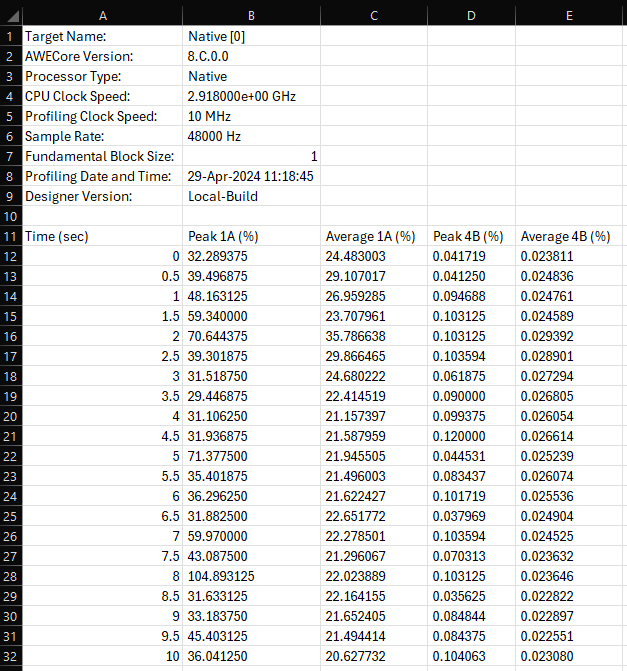

The Profile Peak .csv file is structured as followed, where the Peak and Average Cycle CPU% profile values are indexed by the specified time period in seconds:
Profile Peak Exported CSV

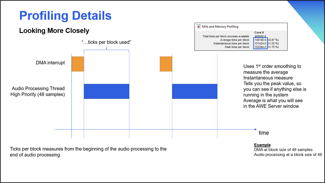

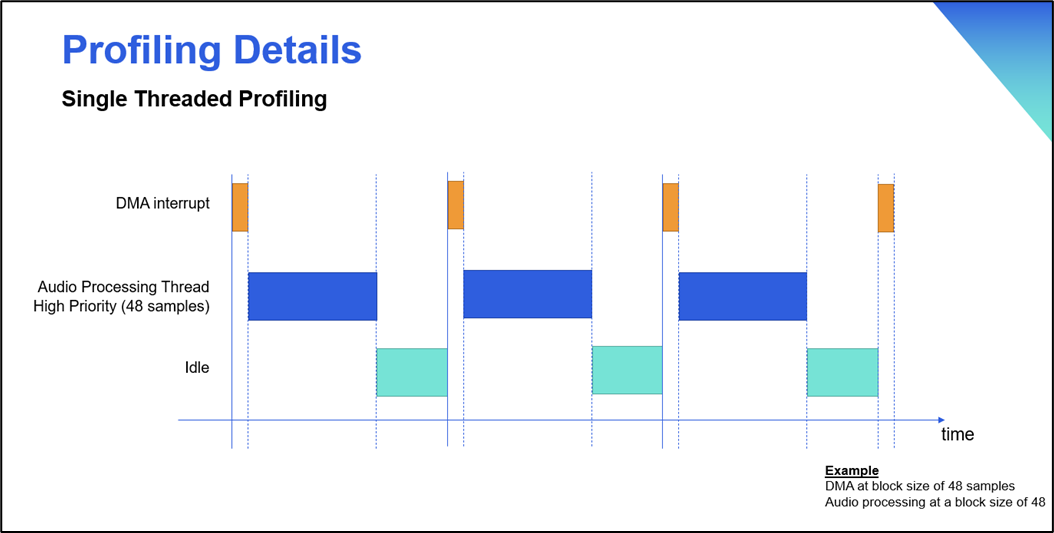

Profiling Details: Single Threaded Profiling
Profiling Details: Total ticks Per Block Process Available
Profiling Details: Ticker Per Block

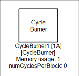

CycleBurner Module
The CycleBurner intentionally consumes a user-specified number of clock cycles. You can increase the number of clock cycles used by CycleBurner by adjusting the ‘numCyclesPerBlock’ slider of CycleBurner’s inspector. Using this technique we can increase the number of cycles until we start to hear distortion in the program material that is being processed by the signal flow.
CycleBurner Module
If a higher priority tasks pre-empt the CycleBurner, the execution time of the CycleBurner will remain constant. This assumes that the module is pre-empted and the pre-emption completes before the Cycle Burner completes.

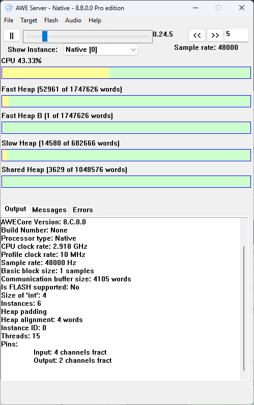

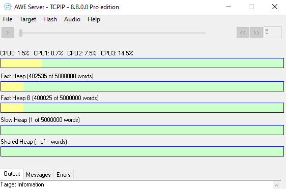

While an .awd is running in Audio Weaver, the Audio Weaver Server provides real time CPU and Memory profiling of the entire layout:
Audio Weaver Server Profiling
Server Profiling on Multi-CPU Targets
AWE Core may be running in multiple threads on several CPUs in some instances. The application is not aware of which CPU the thread is running on by default. This means that without some extra work, the default display of CPU % cannot be trusted for multi CPU targets as the assumption will be that all threads run on a single CPU.
If CPU affinities are enabled on the target, server will display text percentages for each CPU that a layout is running on. The CPU percentage indicator bar will show the load for the CPU which has the highest load. Any CPUs without an associated layout will not be shown.
Setting and getting CPU affinities is done through the AWE Core functions awe_fwSetLayoutCoreAffinity and awe_fwGetLayoutCoreAffinity. These functions are described in the AWE Core API documentation. Customers utilizing AWE Core OS have this feature built in as described here.
