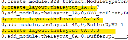

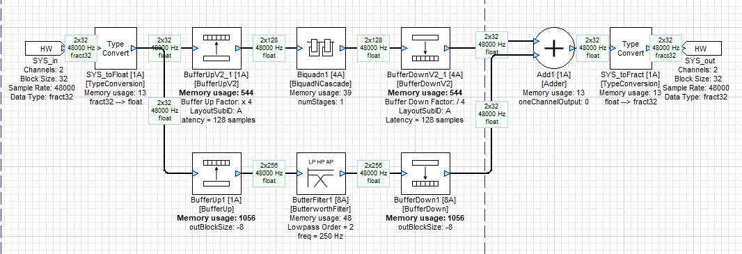

Within the generated AWS file you will find descriptions of the modules and connections. Each distinct section containing modules running at a different block time will generate a “create_layout” command within this script. So, “layout” or “sublayout” is also used to refer to a section within a design which runs at a different clock frequency as the input pin.
For example, the following layout includes 3 separate block times, 1A, 4A, and 8A. These numbers indicate the block time relative to the input pin at the input of the module in question.
![](../../__attachments/3171320562/att_3_for_3039887432.png?inst-v=326272e9-cc04-48f3-a51a-5d633eb0a230)
The generated AWS file includes 3 corresponding “create_layout” lines, as shown:
![](../../__attachments/3171320562/att_1_for_3039887432.png?inst-v=326272e9-cc04-48f3-a51a-5d633eb0a230)

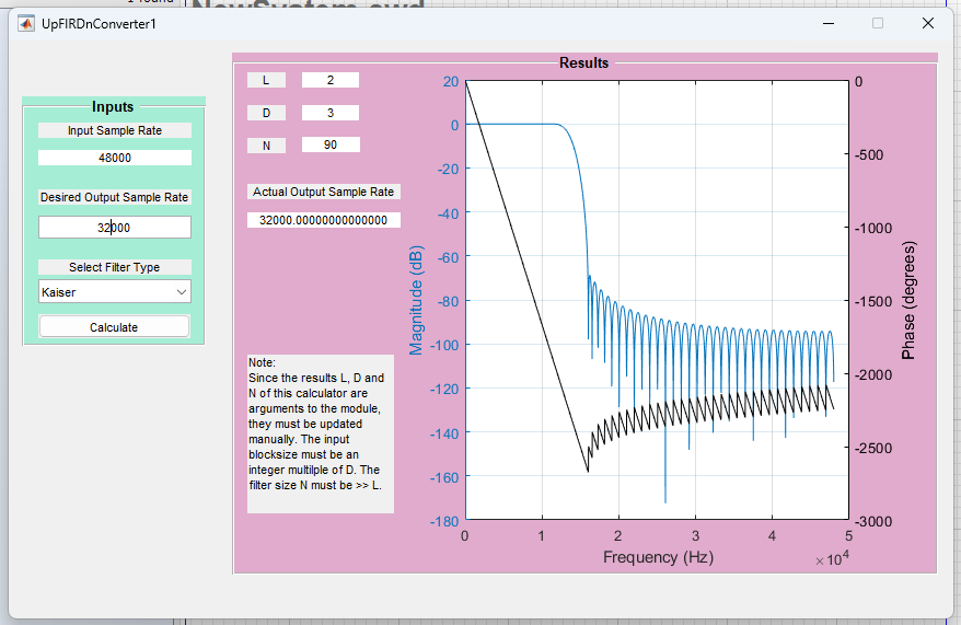

Drop the UpFIRDnConvertor into your design and open the inspector. This shows your input settings and the resulting filter parameters and performance.
![](../../__attachments/3171320562/att_4_for_3039887432.png?inst-v=326272e9-cc04-48f3-a51a-5d633eb0a230)
Set the input and desired output sampling frequencies, the filter type, then click on calculate.
![image-20240109-185746.png](../../__attachments/3171320562/image-20240109-185746.png?inst-v=326272e9-cc04-48f3-a51a-5d633eb0a230)
The filter parameters L, D, and N will be shown.
![image-20240109-185759.png](../../__attachments/3171320562/image-20240109-185759.png?inst-v=326272e9-cc04-48f3-a51a-5d633eb0a230)

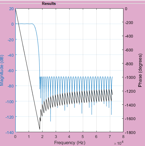

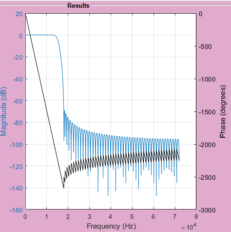

Choose different filter types to see the effect on the stopband attenuation and filter size.
![image-20240109-185821.png](../../__attachments/3171320562/image-20240109-185821.png?inst-v=326272e9-cc04-48f3-a51a-5d633eb0a230)
Kaiser filter
![image-20240109-185854.png](../../__attachments/3171320562/image-20240109-185854.png?inst-v=326272e9-cc04-48f3-a51a-5d633eb0a230)
Parks-McClellan filter
In this example, if we had an input block size of 32, we could not implement a target sample rate of 32000 Hz properly as D needs to be a factor of the input block size.
![image-20240109-190000.png](../../__attachments/3171320562/image-20240109-190000.png?inst-v=326272e9-cc04-48f3-a51a-5d633eb0a230)
![image-20240109-190014.png](../../__attachments/3171320562/image-20240109-190014.png?inst-v=326272e9-cc04-48f3-a51a-5d633eb0a230)
However, with an input block size of 48 bytes, 32000 Hz would be supported as 48 = 16 * 3.

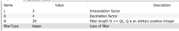

Use the calculated values for L, D, and N to manually set the following Arguments for this Module:
![](../../__attachments/3171320562/att_2_for_3039887432.png?inst-v=326272e9-cc04-48f3-a51a-5d633eb0a230)
