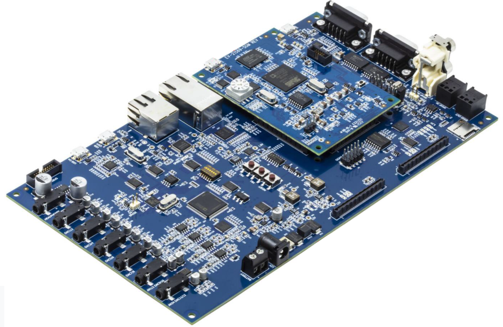

This guide contains instructions for deploying Audio Weaver custom modules to SHARC target hardware. This guide specifically uses the ADI-21569-SOM EVK, but the general process should be applicable for other SHARC target hardware.

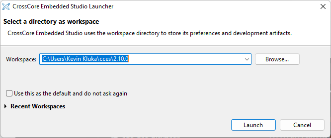

Set up CCES workspace directory:
Figure 1: CCES Studio Launcher Workspace Directory
The default directory is fine unless another directory is preferred.

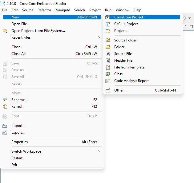

Create a new CrossCore Project. ‘File > New > CrossCore Project’:
Figure 2: New CrossCore Project

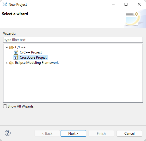

When prompted, select the CrossCore Project Wizard:
Figure 3: CrossCore Project Wizard

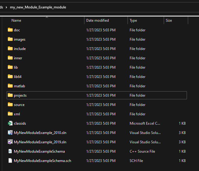

The standard Audio Weaver Module folder structure is pictured below:
Figure 4: Standard Audio Weaver Module Folder Structure
NOTE: Refer to the Bringing Algorithms into Audio Weaver Application Note, Developing Custom Modules: Quick Start Guide, and Developing Custom Modules: Guide more information about the standard Audio Weaver Module folder structure.

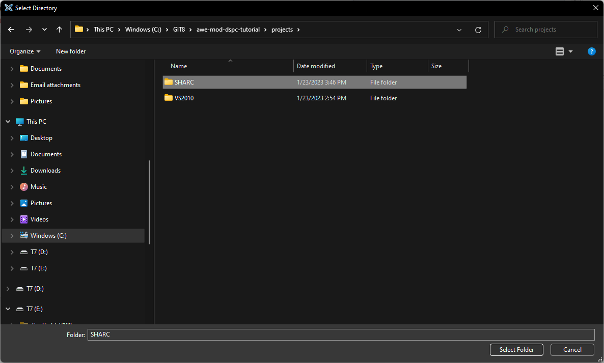

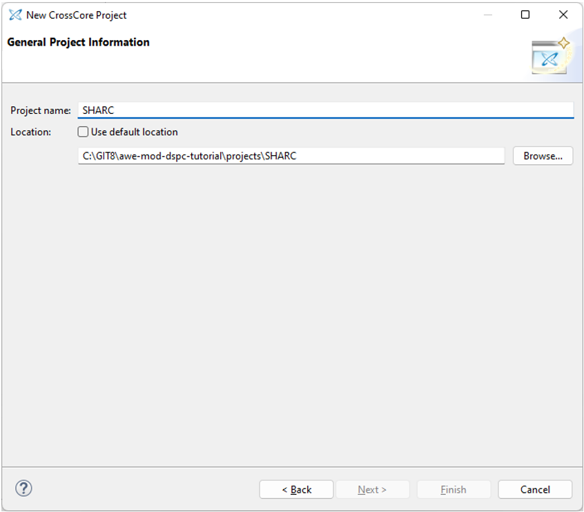

We’ll want to create the CCES Project in the ‘/projects’ folder of the Custom Module directory to keep things contained and prevent path errors. After selecting the CrossCore Project Wizard, set the CrossCore Project Name and path as below. You may have to create a new ‘SHARC’ folder in ‘/projects’:
Figure 5: SHARC CrossCore Project Folder Path
Figure 6: CCES Project Name and Location

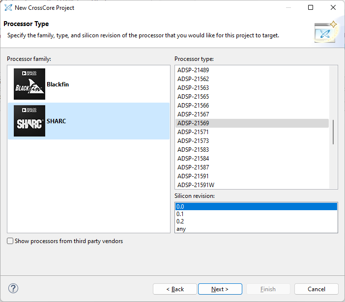

Click ‘Next’ and choose the appropriate SHARC DSP you’re using in the next prompt. In this case, we select SHARC ADSP-21569:
Figure 7: CrossCore Project Processor Type

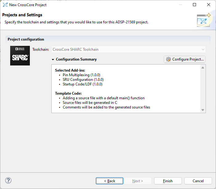

Click ‘Next’, and then ‘Finish’ in the next Projects and Settings prompt:
Figure 8: CrossCore Projects and Settings

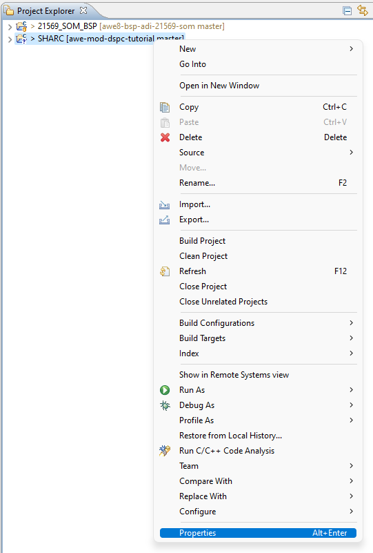

Right click on the ‘SHARC’ project that we created in the previous steps, and navigate to ‘Properties’ in the context window:
Figure 9: SHARC Project Properties

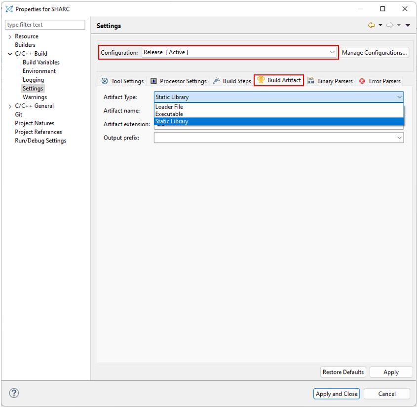

Navigate to ‘C/C++ Build > Settings’ for the Release Build Configuration, and in the ‘Build Artifact’ Properties tab, and choose ‘Static Library’ for the Artifact Type:
Figure 10: Release Build Artifact Type

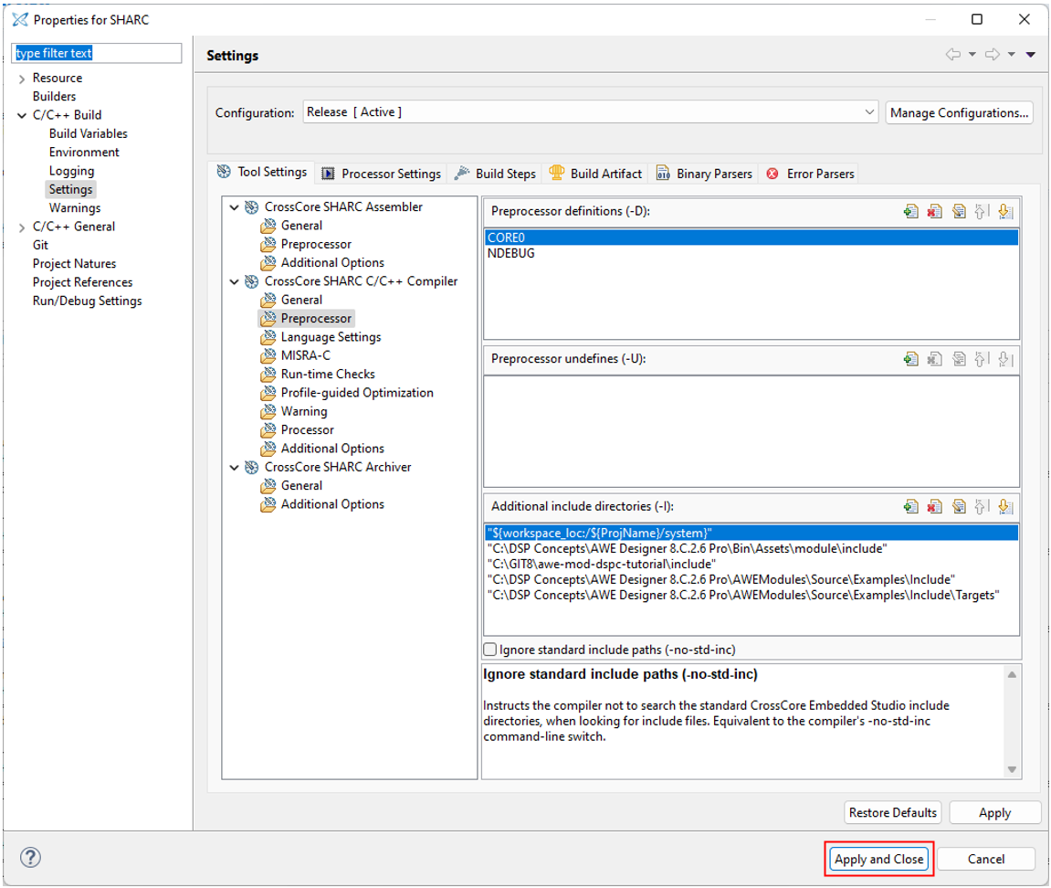

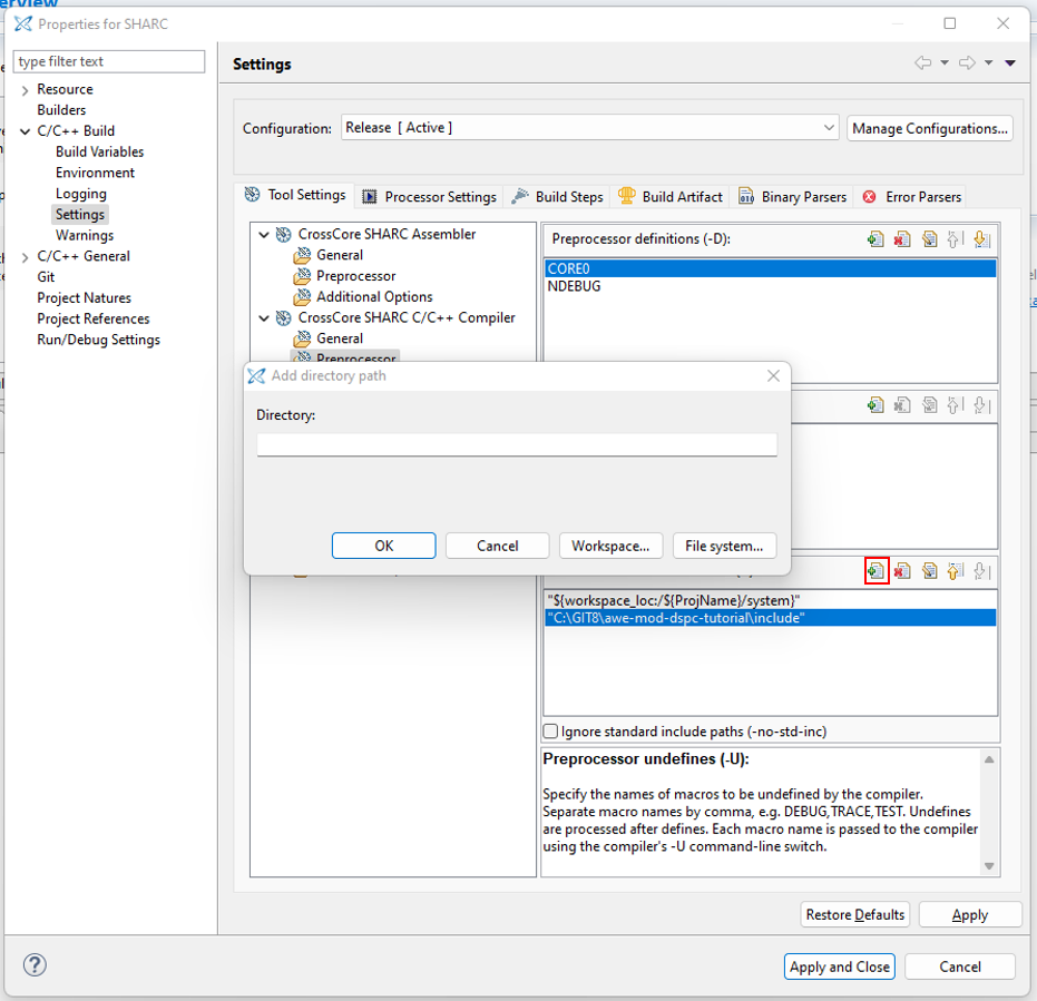

Navigate to ‘C/C++ Build > Settings’ for the Release Build Configuration, and in the ‘Tool Settings’ Properties tab, add the following paths to the ‘Additional include directories’:
  • C:\DSP Concepts\AWE Designer 8.C.2.6 Pro\AWEModules\Source\Examples\Include
  • C:\DSP Concepts\AWE Designer 8.C.2.6 Pro\AWEModules\Source\Examples\Include\Targets
  • C:\DSP Concepts\AWE Designer 8.C.2.6 Pro\Bin\Assets\module\include
Figure 11: Additional Include Directories
Click ‘Apply and Close’:
Figure 12: Apply Custom Module CrossCore Properties and Settings

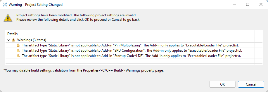

It is ok to disregard these warnings if notified after applying the settings:
Figure 13: Custom Module CrossCore Project Settings Change Warning

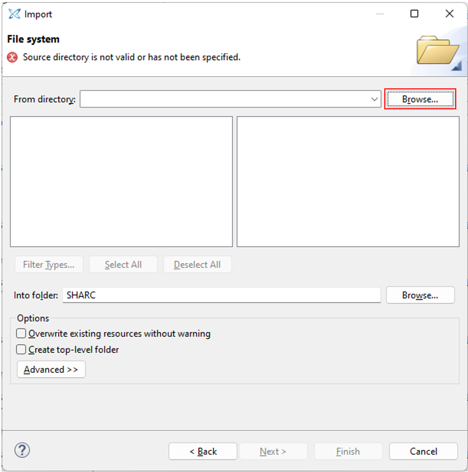

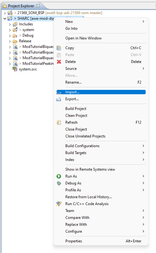

Right click on the ‘SHARC’ project in the Project Explorer tab on the left hand side of the CCES IDE window, and select to ‘Import’ from the context window:
Figure 14: Import Custom Module C Code

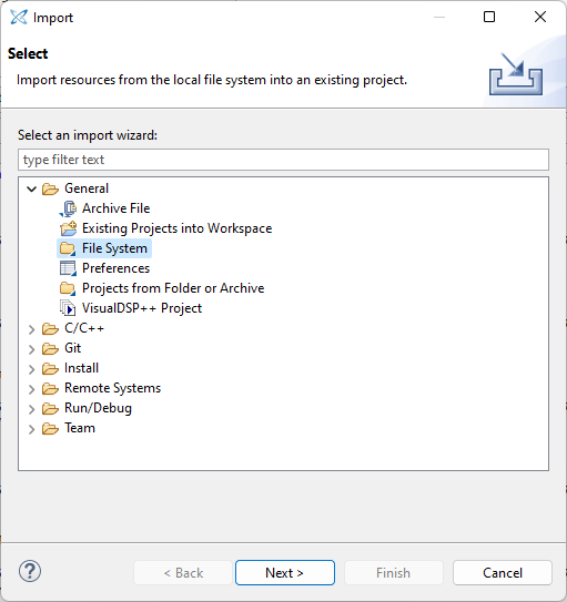

Select ‘File System’ from the Import Wizard and click ‘Next’:
Figure 15: Import Wizard - Import File System

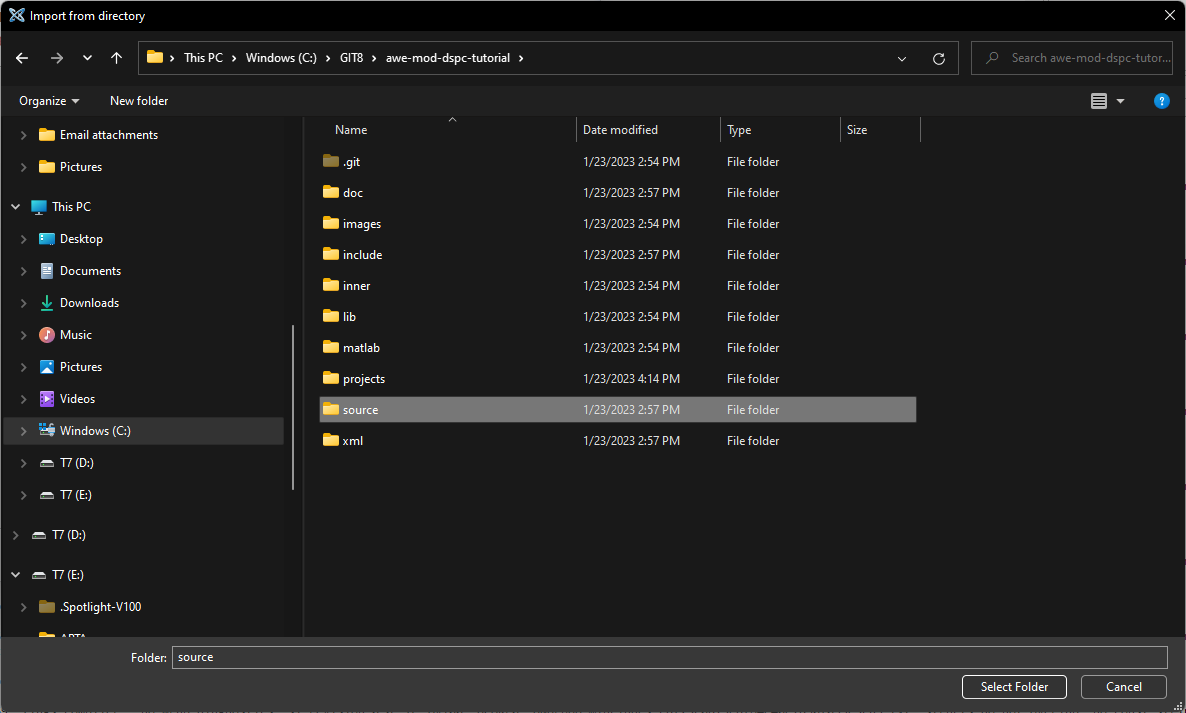

Select ‘Browse’ to navigate to the directory containing the Custom Module C code:
Figure 16: Custom Module C Code Directory
The standard path that the generated C files from the Custom Module make_*.m script are placed in the ‘source’ folder of the parent Custom Module directory (<DIR>\source). Select the ‘source’ folder of the Custom Module directory as the directory to be imported from:
Figure 17: Custom Module Source Directory

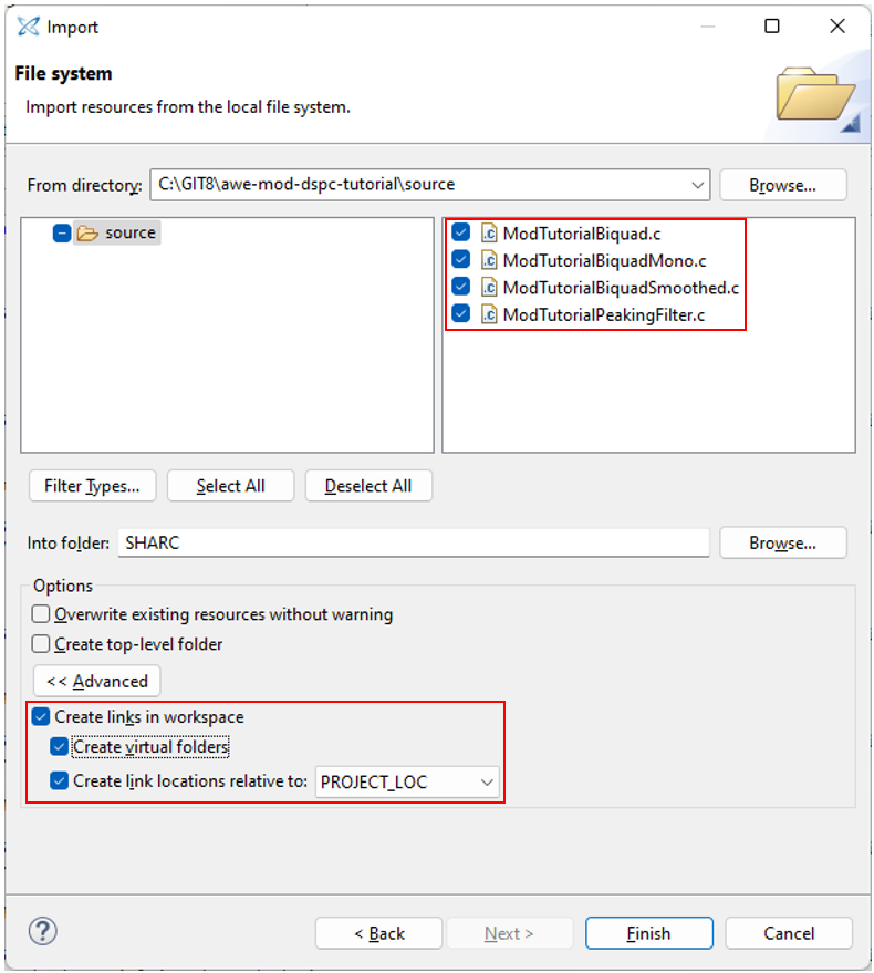

Select the Custom Module C files to be added to the project, with the following import settings and click ‘Finish’:
Figure 18: Import Custom Module C Files

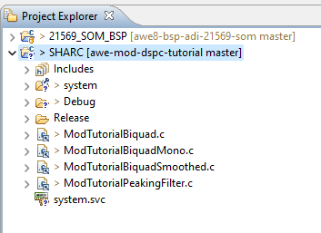

You should now be able to see the Custom Module C Files included in the SHARC project, in the CCES IDE Project Explorer tab:
Figure 19: Included Custom Module C Files

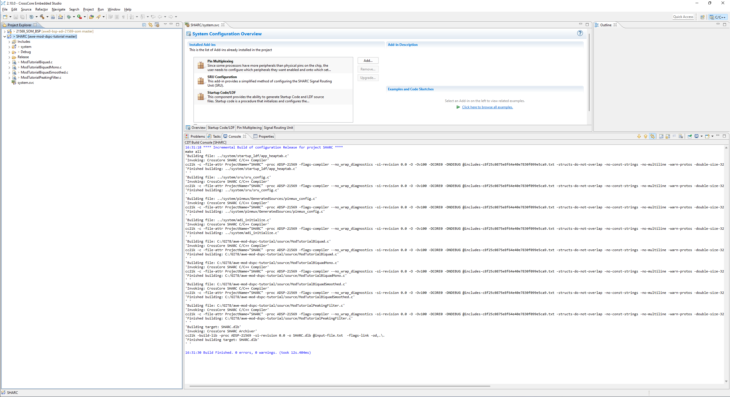

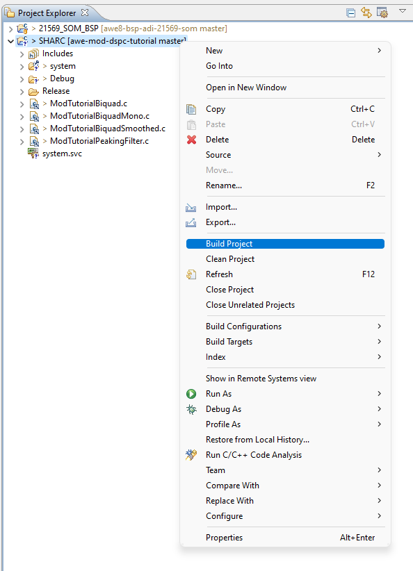

Right click on the SHARC project in the CCES IDE Project Explorer tab and select ‘Build Project’ to build the Custom Module .dlb library:
Figure 20: Build Custom Module .dlb Library
After building the project, you should see a Build Finished confirmation in the CCESSS IDE console:
Figure 21: Custom Module .dlb Build Finished

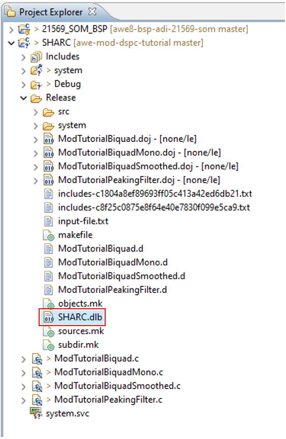

You should now see the Custom Module .dlb library (SHARC.dlb) under the Custom Module Project in the CCES IDE Project Explorer:
Figure 22: Built Custom Module .dlb Library

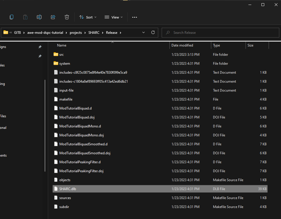

The Custom Module .dlb Library should be located in the ‘Release’ folder of the SHARC project directory:
Figure 23: SHARC Release Build Folder

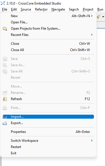

From the top CCES IDE menu bar, select ‘File > Import’:
Figure 24: BSP Project Import

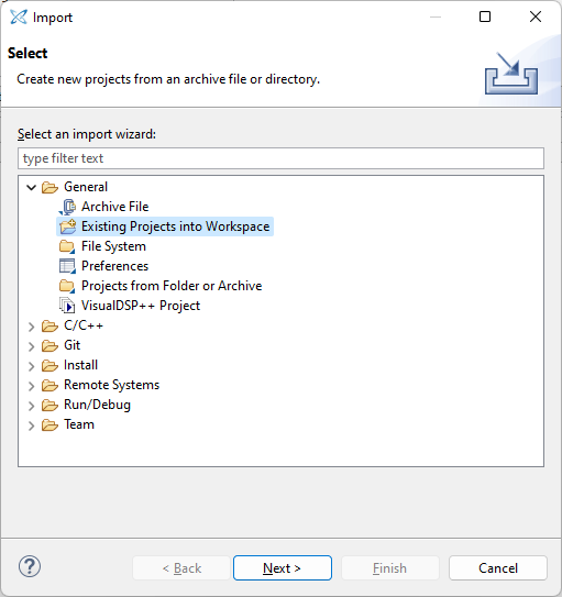

Select ‘General > Existing Projects into Workspace’ from the pop-up CCES IDE Import Wizard:
Figure 25: Import Existing Projects Into Workspace

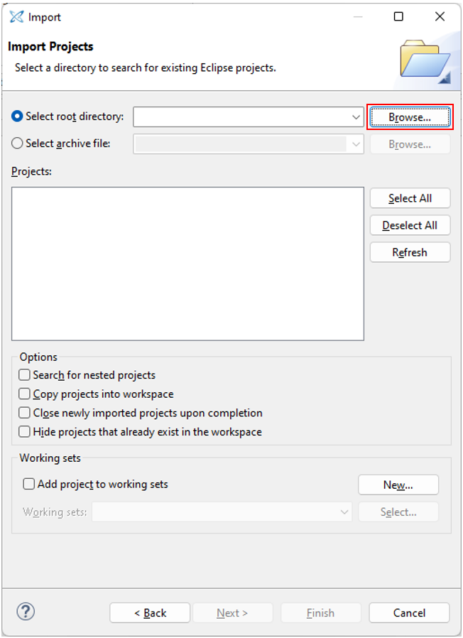

Select the ‘Browse’ button to locate the ADI-21569-SOM BSP Project directory:
Figure 26: Browse for ADI-21569-SOM BSP Directory

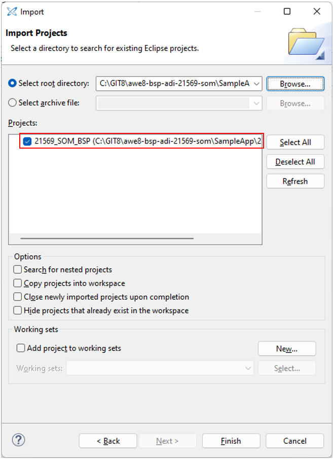

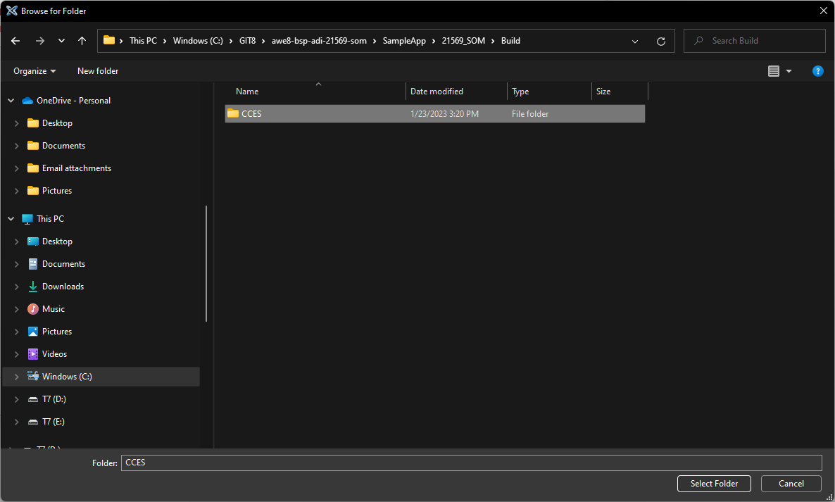

The ADI-21569-SOM BSP should be located in the ‘<DIR>\awe8-bsp-adi-21569-som\SampleApp\21569_SOM\Build\CCES’ folder. Select the ‘CCES’ folder:
Figure 27: CCES ADI-21569-SOM BSP Folder
Select the ‘21569_SOM_BSP’ to be imported and click ‘Finish’:
Figure 28: 21569_SOM_BSP

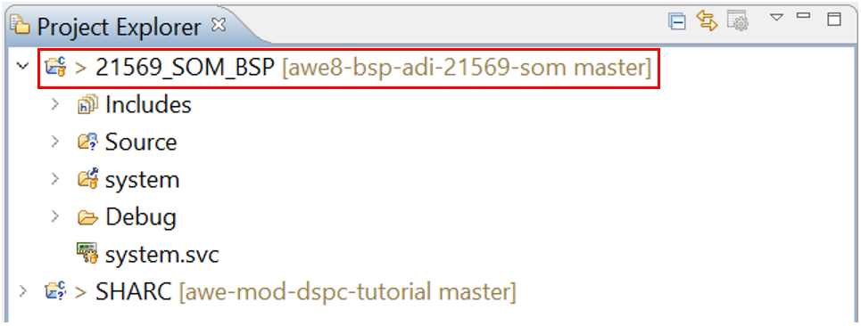

You should now see the ‘21569_SOM_BSP’ in the Project Explorer in the left hand side of the CCES IDE window:
Figure 29: 21569_SOM_BSP Imported

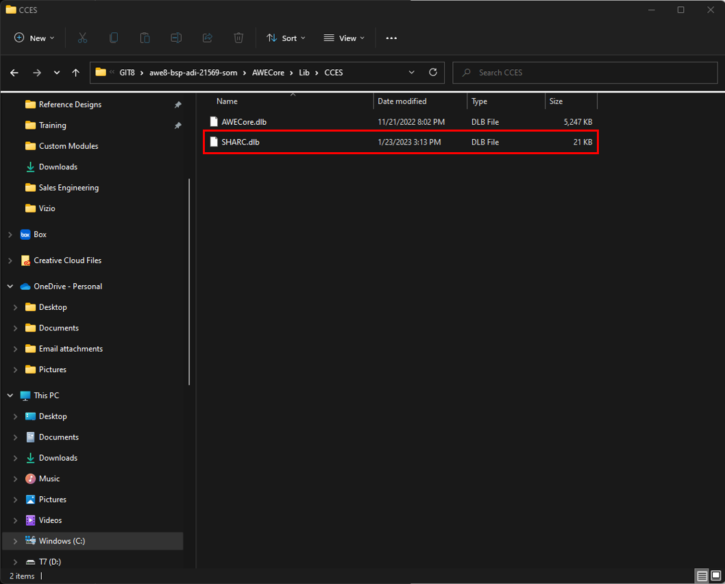

Copy the SHARC.dlb Library we built in Section 3.3 to the ‘<DIR>\awe8-bsp-adi-21569-som\AWECore\Lib\CCES’ folder, such that it shares a common path with AWECore.dlb:
Figure 30: Copy SHARC.dlb Library

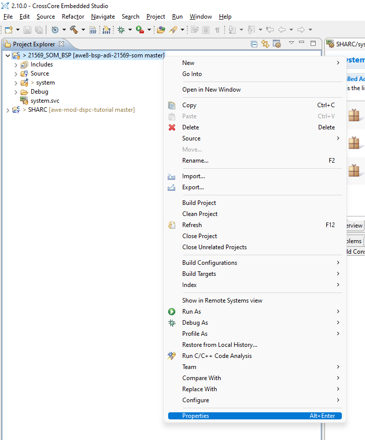

Right click on the ‘21569_SOM_BSP’ project in the CCES IDE Project Explorer and navigate to ‘Properties’ in the context menu:
Figure 31: 21569_SOM_BSP Properties

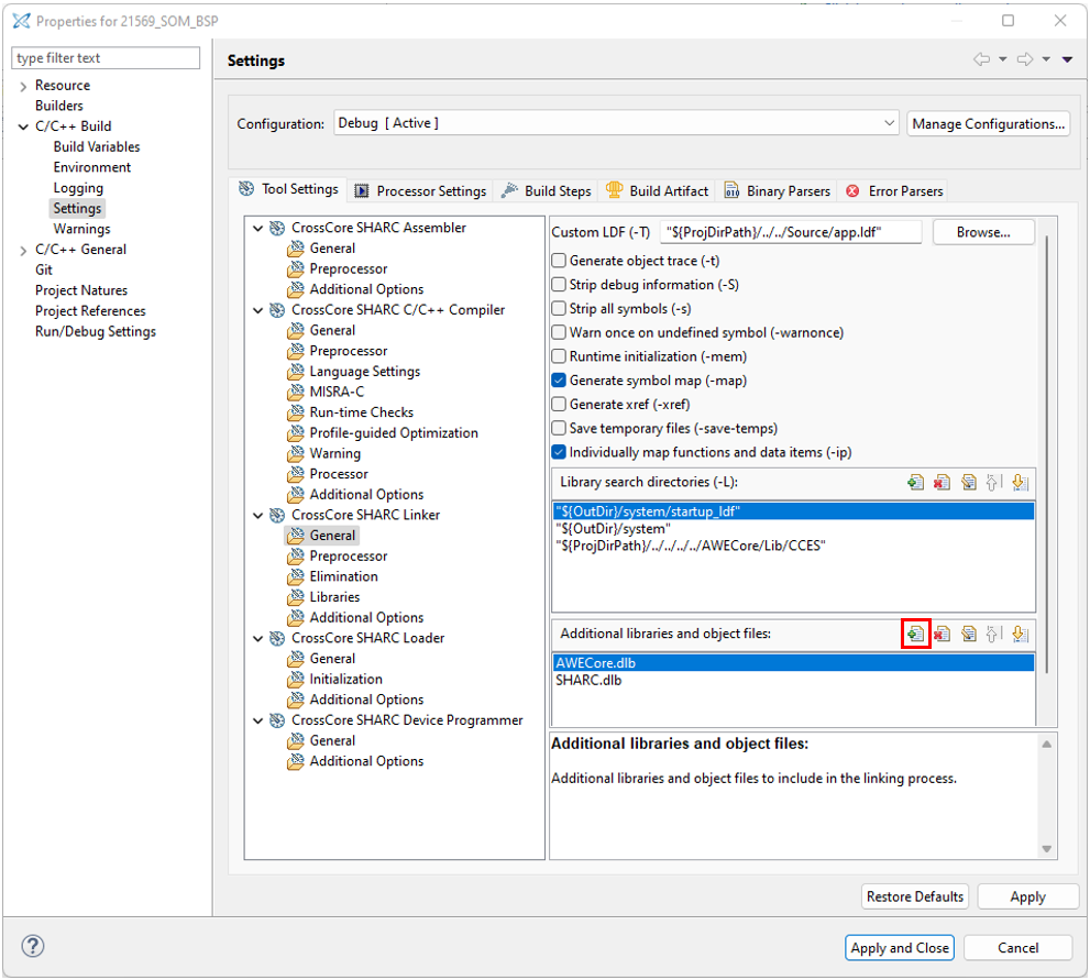

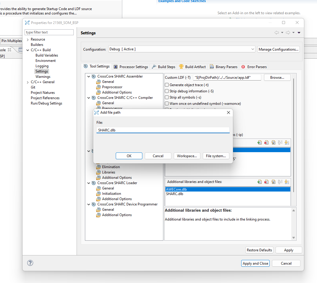

In the ‘C/C++ Build > Settings’ Debug Build Configuration Tool Settings tab, under ‘CrossCore SHARC Linker > General’, click on the ‘+’ button in the ‘Additional libraries and object files’ pane:
Figure 32: Add Additional Libraries and Object Files to CrossCore SHARC Linker
Since we copied the SHARC.dlb library to the same path as the AWECore.dlb library in a previous step, we can simply type in ‘SHARC.dlb’ in the File Path input bar:
Figure 33: Add SHARC.dlb to CrossCore SHARC Linker
Click ‘Ok’ and then ‘Apply and Close’.

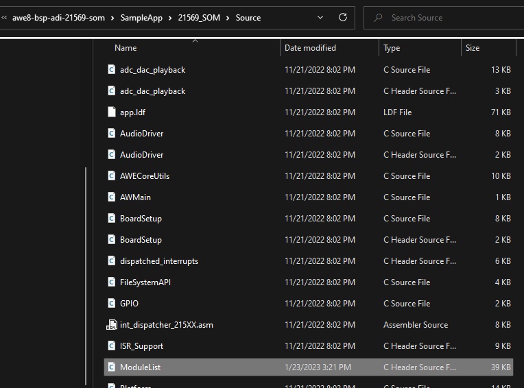

Navigate to the ‘<DIR>/awe8-bsp-adi-21569-som/SampleApp/21569_SOM/Source’ folder and open ModuleList.h for editing:
Figure 34: ModuleList.h

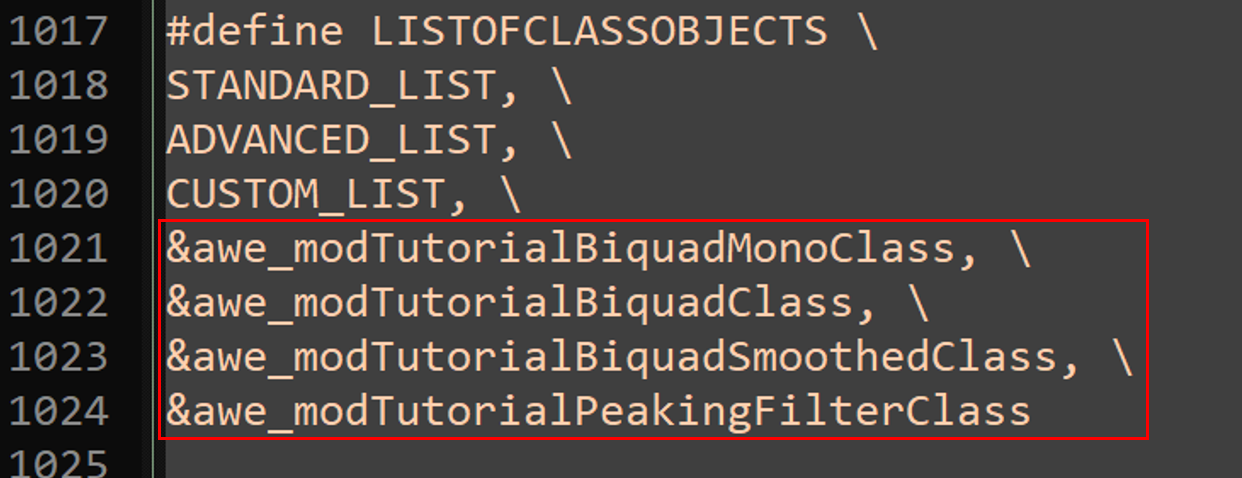

The ModuleList.h header file contains an array LISTOFCLASSOBJECTS that represents the list of all modules to be linked into the BSP build, so to use our new custom modules, we must add their symbols to this array.
NOTE: For more information about ModuleList.h and its functionality, refer to the Optimization section of the AWE Core 8 Integration Guide.
We must edit ModuleList.h in two places:
  1. Declare the custom module symbols as extern const int variables
  2. Add the custom modules to the preprocessor array
Also notice the naming convention. This naming convention must be followed to successfully link the new module classes.

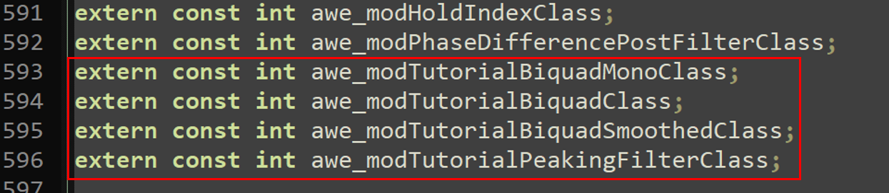

First, we add the symbol variables:
Figure 35: ModuleList.h Symbol Variables
Next, add the new module variables to the LISTOFLCASSOBJECTS array:
Figure 36:ModuleList.h LISTOFCLASSOBJECTS Array

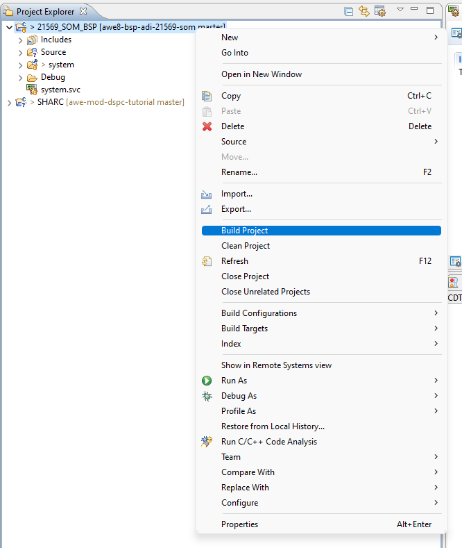

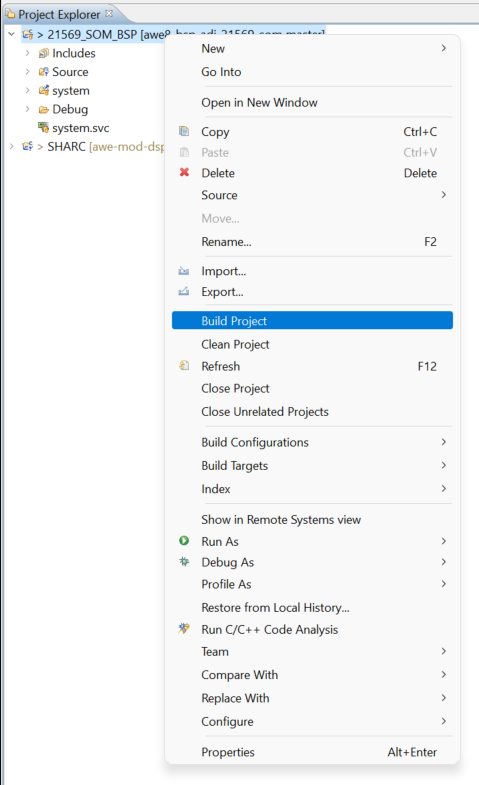

Right click on the ‘21569_SOM_BSP’ in the CCES IDE Project Explorer, and select ‘Build Project’ from the context menu:
Figure 37: Build 21569_SOM_BSP Project

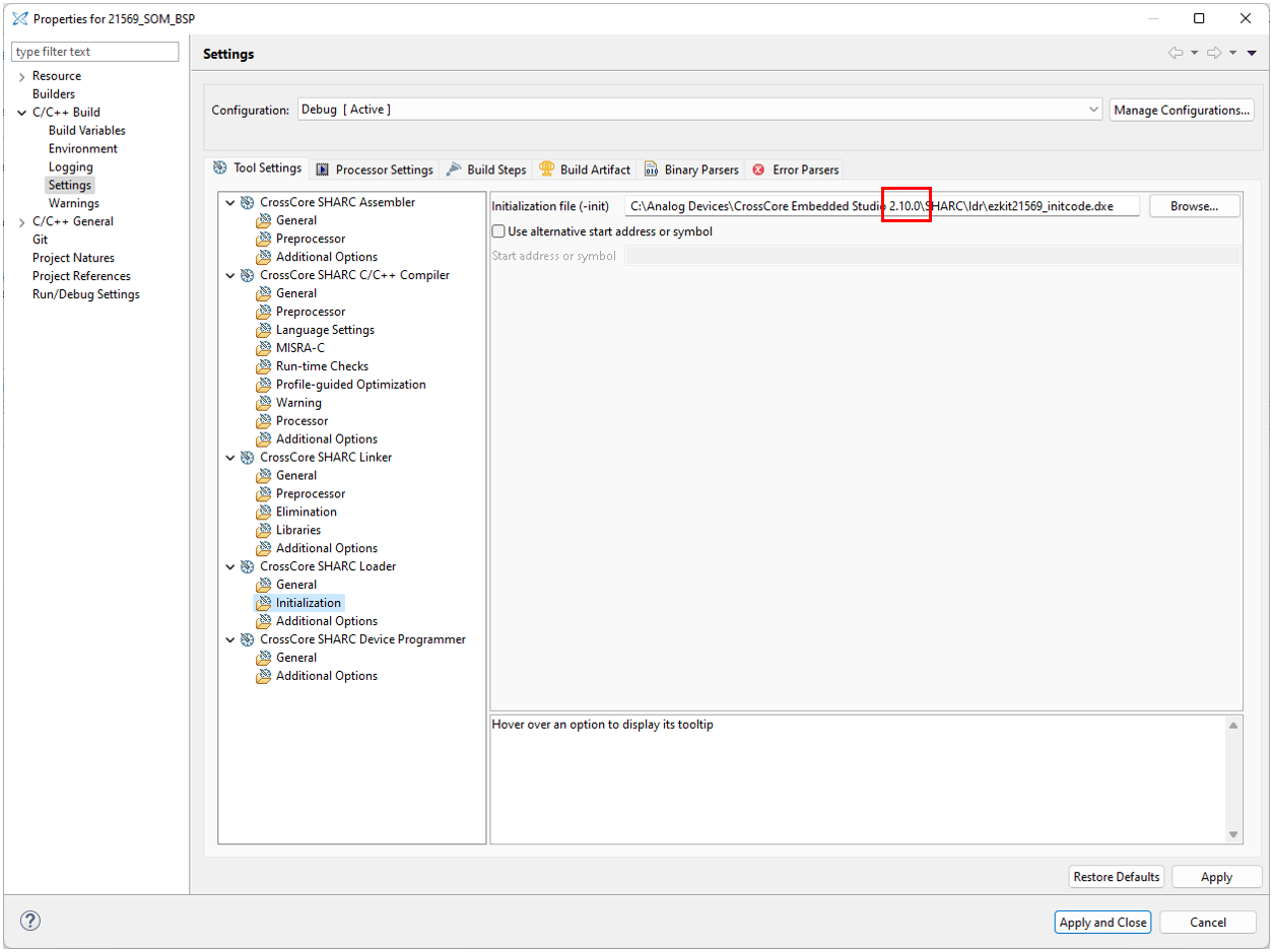

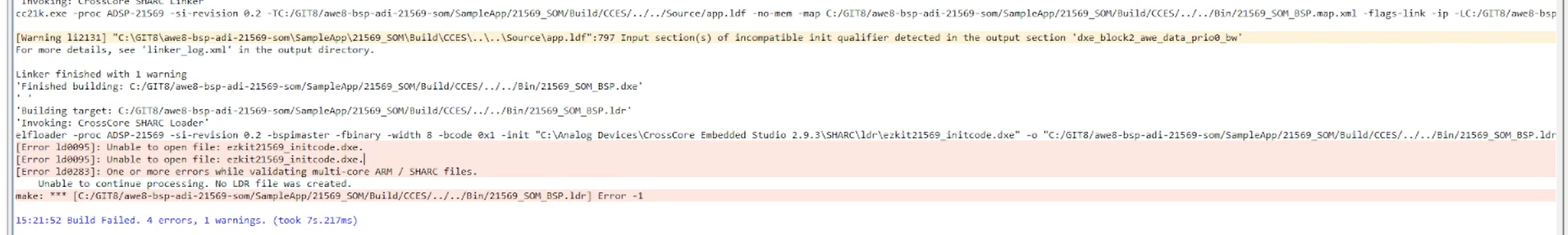

NOTE: If you get an error message about opening the ‘ezkit21569_initcode.dxe’ file, it may be because you are using a different version of CCES than the version the original BSP was built with:
Figure 38: Unable to Open File: ezkit21569_initcode.dxe

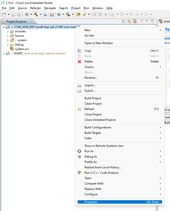

To remedy this, right click on the ‘21569_SOM_BSP’ in the CCES IDE Project Explorer, and select ‘Properties’ from the context menu:
Figure 39: 21569_SOM_BSP Properties
Navigate to the ‘C/C++ Build > Settings’ Debug Build Configuration Tool Settings tab, under ‘CrossCore SHARC Loader > Initialization’, and edit the Initialization file path to match the CCES IDE version you are using:
Figure 40: CrossCore SHARC Loader CCES IDE Version Initialization File Path
The ‘CrossCore Embedded Studio x.xx.x’ needs to match the CCES IDE you are using.

Right click on the ‘21569_SOM_BSP’ project in the Project Explorer and select ‘Build Project’ from the context menu:
Figure 41: Build 21569_SOM_BSP

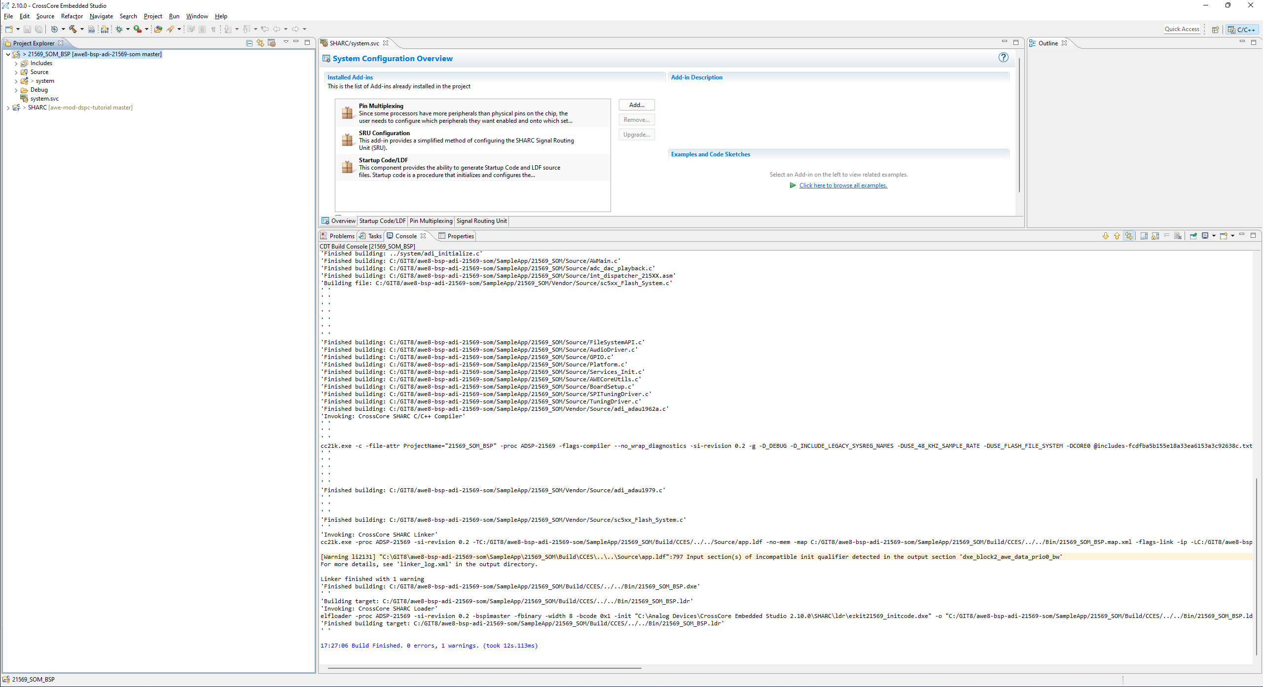

Upon successful completion of the BSP image build, you should see confirmation in the CCES IDE console window:
Figure 42: 21569_SOM_BSP Build Success

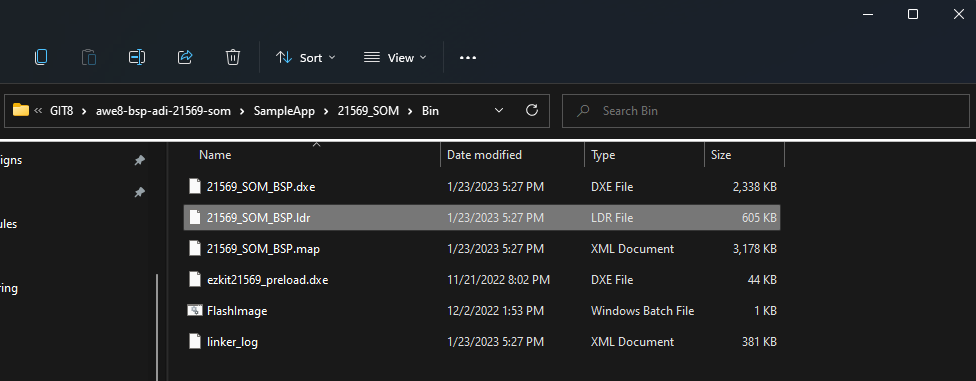

The ‘21569_SOM_BSP.ldr’ flash image will be placed in the ‘<DIR>\awe8-bsp-adi-21569-som\SampleApp\21569_SOM\Bin’ directory:
Figure 43: 21569_SOM_BSP.ldr
